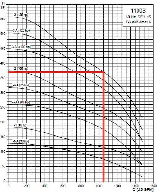

Although selecting high-efficiency pumps for irrigation applications is important, pump sizing is equally critical to reduce energy consumption and costs. In fact, incorrect sizing is a common reason for low pumping efficiency. Optimal pump selection requires choosing the product that is best suited to the operating conditions required by the irrigation application. To ascertain whether the operating conditions are stable, users must calculate how much pump flow and head are required.
Calculating Flow
End users should determine the amount of water to be applied during the peak period by multiplying the size of the field by the amount of water in inches that must be applied. The result is then converted to gallons per minute (gpm), and this number determines the size of the pump. For example, to grow corn on a 50-acre field using water from a well, a pump with best efficiency at 524 gpm could pump for 24 hours per day. However, to allow for system downtime and power cost windows, a larger pump will always be chosen, and a runtime of between 12 and 18 hours per day is typical.
Calculating Head
An irrigation pump has to overcome the following four elements of pressure:- Pressure required for the application devices (such as sprinklers, spray heads and drippers)
- Friction loss from the piping system, pipes, screens, valves, elbows and tees
- Elevation lift
- Suction lift
- There is no suction lift.
- The drawdown has to be added to the elevation lift.
- The application device uses 10 psi of pressure, or 23 feet of head.
- The friction loss in the pipes, elbows, valves and tees has been calculated to 30 psi, or 69 feet of head.
- Assume that the elevation lift is only 58 feet of head.
- The static water level is 200 feet (this corresponds to suction lift for a surface pump).
- The drawdown in the well is 10 feet.
