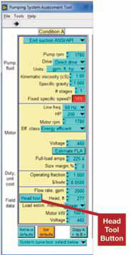

Analyze the Data
Data analysis can be done by hand. An example document can be downloaded at www.pdcubed.net showing a complete hand calculation with the accompanying equations. These formulas can be used to develop a custom spreadsheet for those who prefer to work in spreadsheets or who have multiple data points.
Also, a free tool developed by the U.S. Department of Energy is available to help analyze your data. The program is called Pump System Assessment Tool (PSAT). It can be downloaded at http://www1.eere.energy.gov/industry/bestpractices/software_psat.html.
Input for this tool is the raw measurement data; output is the pump's performance, yearly energy usage and cost to operate. The tool also compares the current pump against a theoretical, optimum pump based on the achievable efficiency estimate generated from the Hydraulic Institute Standard. This contrast shows approximately how much money could be saved yearly if the optimal pump were installed (Figure 1).
Figure 1. PSAT input area
Figure 2. Head calculation tool for suction and discharge pressures
To run PSAT, the user enters information about the pump and the motor driving it in the PSAT input area (Figure 2). The box at the bottom of the column is where the flow head and input power data taken during testing is entered. The user can calculate the total head of the pump by hand, or it can be calculated by the PSAT by clicking the blue “Head tool” button next to the input box. This brings up a calculator where you input your system and measured data. The tool will calculate the total head (Figure 3). If you have a system without a suction pressure gauge, the tool can also calculate the total head by selecting “suction tank elevation, gas space pressure and discharge line pressure”.
