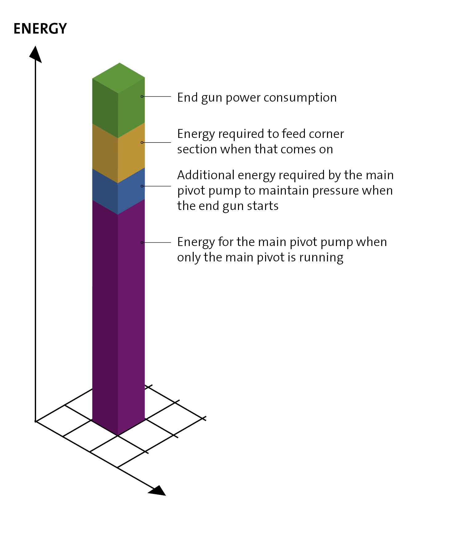

Earlier, the importance of maintaining a constant pressure in a pivot irrigation system was explained. This becomes relevant if the pivot is equipped with an end gun and maybe even a corner section. As soon as the end gun or corner section comes on, the pressure in the pivot’s main line will drop. This will impact the irrigation uniformity.
The solution is to replace the pivot’s main pump with a variable speed pump, which will immediately react to a pressure drop when an end gun or corner section cuts in. In such a configuration, it is possible to maintain the same pressure on all the sprinklers and, therefore, deliver high uniformity (see Figure 1).
Figure 1. If a pump is specified to run continuously at the highest level—for example when the corner section comes on—energy is wasted. The different requirements for optimal energy use on a pivot application can be met by using a variable speed pump. This offers substantial energy savings while maintaining pressure requirements.
