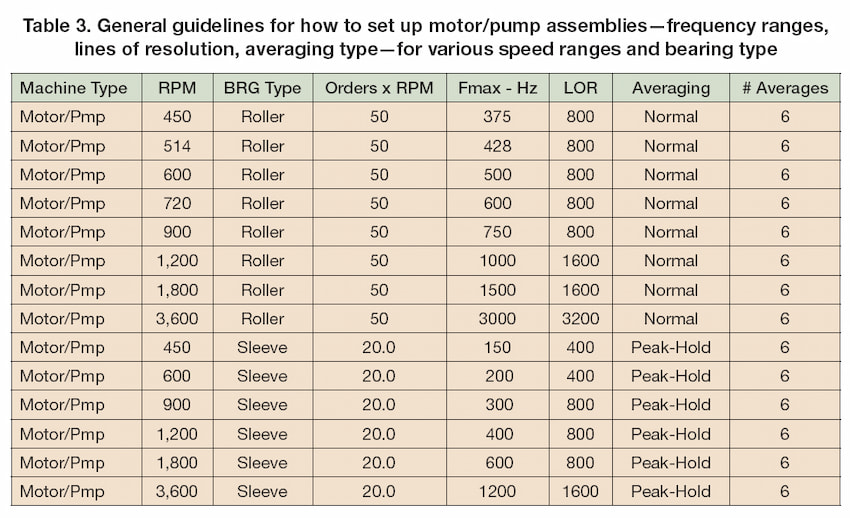

The direction of the vibration measurement or plane of measurement will also determine the machine vibratory problem. Since vibration can occur throughout a broad frequency range, Table 3 has recommended frequency ranges and lines of resolution to help find particular machine problems. Severity indicates how bad the problem (Table 2) is, and frequency indicates what is causing the problem (Table 4). Vibration measurements have three different amplitudes as follows:

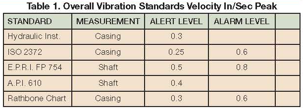

Overall vibration severity is used for determining the condition of a machine.  There are several standards and guidelines for determining severity of machine vibration as shown in Table 1.

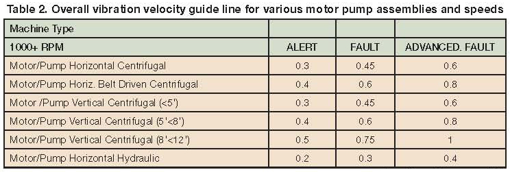

The overall vibration velocity levels are over 0.8749 In/Sec Peak (Refer to Table 2 for three tier alarm criteria for 1,000-plus rpm horizontal centrifugal pump). Overall vibration was in excess of 0.6 In/Sec Peak which indicates an advanced fault. Refer to Figure 1. Go to the left-hand side, amplitude In/Sec Peak, and look up 0.8749 In/Sec Peak which indicates danger failure near.
