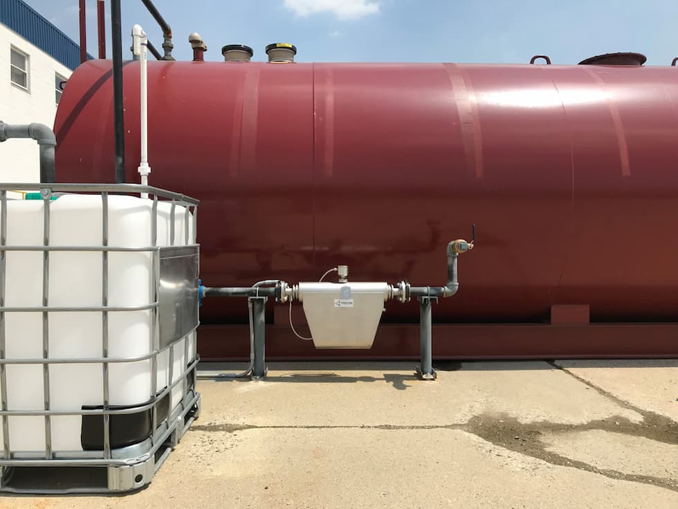

Accurately monitoring the custody transfer of diesel and gasoline from outdoor storage tanks to tanker trucks required a different flow measurement solution. For this, the plastics recycling manufacturer needed a highly accurate flow monitoring system that interfaced with its plant network to facilitate custody transfer and billing to its users. Because the tanks and meters are outdoors, the flow meter needed to maintain accuracy in the face of changing temperatures and fuel densities and reliably work in Michigan’s harsh weather. Further, the fuel transfer required a high transfer rate and carry C1D1 Ex Certification.
Coriolis mass flow meters met the system’s required maximum flow rate of 200 gallons per minute (gpm) and offered high accuracy, sufficient for custody transfer. Two Coriolis meters were connected to each other on a two-node, multi-drop Modbus network. An ethernet gateway converts data from the two-meter Modbus network to the PLC network’s Ethernet-TCP communications protocol. PLC logic and reporting software allows operators to easily track flow rate, total, temperature and specific gravity of the fuel dispensed to waiting tankers. Meter-mounted transmitters display a batch total for quick and easy comparison to truck-mounted meters. Once verified, the batch total is processed, and the user is automatically billed for onboarded fuel. The batch total is then remotely reset by the PLC and is ready for the next fuel transfer.
The integration of the gateway allows for simplified troubleshooting of the custody transfer meters. Managers can monitor meter performance from their local network computers, enabling them to video call factory technicians and get immediate assistance to diagnose, troubleshoot and advise on parameter changes. This saves travel time and cost and helps keep operations online.
