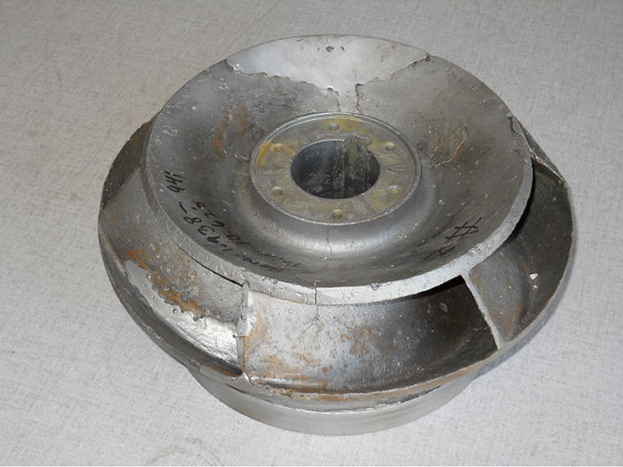

Image 1. Original impeller

The images featured within this article represent the complete reverse engineering process. The model 12KK, vertical pump was disassembled. The components were lain out, and each component was analyzed to determine the repair process. This second-stage impeller (see Image 1) had wear and cracking (because of poor weld repairs made by another company).  It was a perfect candidate for reverse engineering.
