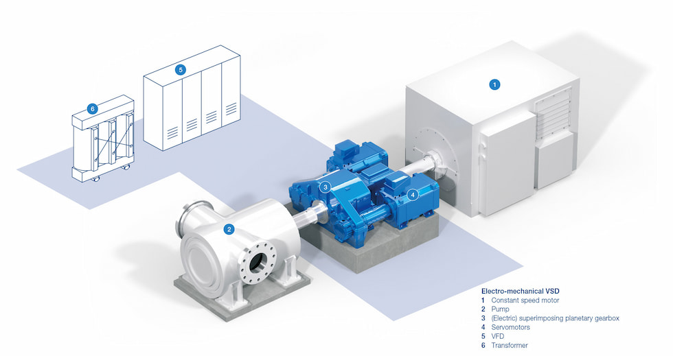

The electromechanical VSD is a recent technology that combines the superimposing planetary gear with VFD technologies and incorporates a concept called the power split principle. The drive layout consists of a constant speed main motor, which is directly coupled to a superimposing planetary gearbox, which is then coupled to the driven pump. Two control servomotors are then connected to the superimposing planetary gearbox, creating an electric superimposing planetary gearbox. The pump speed can then be regulated together with the electric superimposing gearbox plus the constant input speed from the main motor. A VFD provides the control needed for the two servomotors. The layout of the electromechanical VSD solution is shown in Image 2.

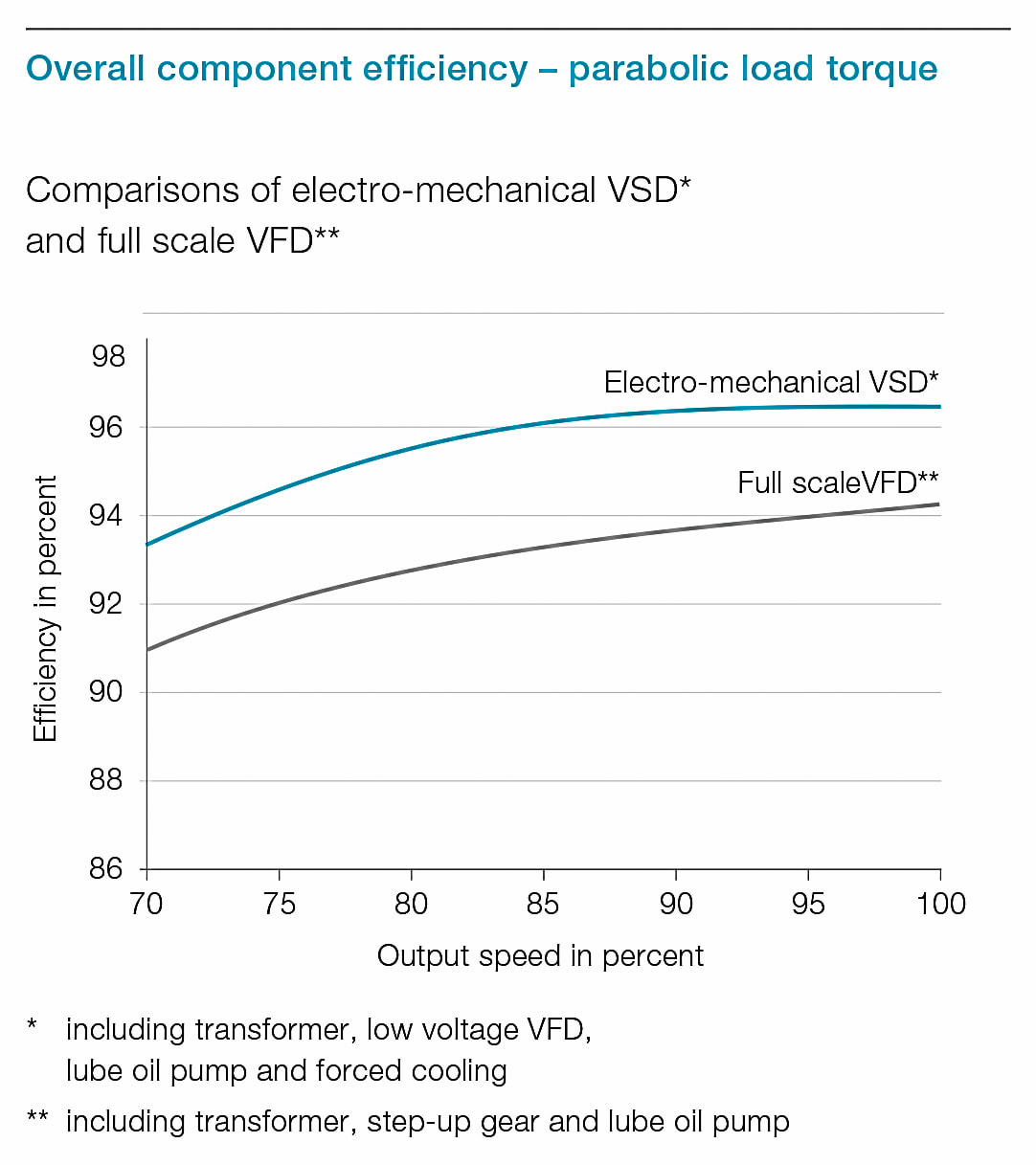

As the electromechanical VSD solution only uses 15% of control power for variable speed regulation, this means VFD losses are proportional only to 15% of power instead of 100% of the power. When calculating the drive train efficiency provided by an electromechanical VSD, the formula in Equation 1 can be applied, which takes into account the power split principle and uses the 15% and 85% power flows within the calculation.
The electromechanical VSD system, therefore, achieves high efficiency across the pump operating range due to only a small portion of power flowing through the VFD line and the majority of power is transmitted purely mechanically. At rated point, efficiencies of up to 97% are possible, which can result in efficiency gains of up to 2.5% when compared to full scale VFD (Image 5). The electromechanical VSD using a small amount of power for control means the VFD has a small footprint and there are savings in weight. Also, there are savings in auxiliaries such as power savings for cooling, the transformer is simplified and the constant speed main motor footprint is reduced from the possibility of derating by around 15% to 20%.
