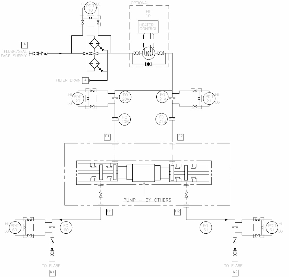

The most common sealing arrangement includes a heated, filtered flush (Plan 12 under API 682) with a low flush rate and a system to monitor vapor leaks in the primary vent (Plan 76). Filtering the seal flush is critical for seal reliability. End users should consider using a duplex filtration system, which allows for uninterrupted operation if the filter element needs replacing, with a 3-micron nominal filter element. End users should also conduct a detailed fluid analysis to determine the appropriate filter element to use.

Typical P&ID diagram of supercritical C02 pump application
Figure 1. Typical PI&D diagram of supercritical C02 pump application

The double-ended pumps in low-speed applications require a relatively simple seal support system with a heated, filtered flush at a low flush rate of one to two gallons per minute and a vapor monitoring system for primary vent gas leakage. Depending on the climate, the system may also need a nitrogen sweep (Plan 72) to prevent primary vent icing.
