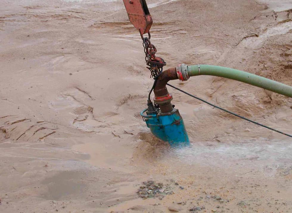

When choosing a pump, it is important to consider the properties of the water at the particular job site. These characteristics will determine the type of pump and materials of construction needed.
For example, clean water has minimal contaminants and sediment, making typical cast iron pumps a viable option. On the other hand, water with a high amount of solids, such as sand or mud, requires slurry or trash pumps with harder impeller materials, such as high-chrome cast iron, to resist abrasion.
image 1 submersible pumpIMAGE 1: Submersible pump for dewatering at a construction site (Image courtesy of Tsurumi America)
Many pumps are designed with an agitator attached to the impeller to stir up the solids, preventing solids from settling near the suction. It is important to know what the water contains, as pumps not meant for solids can clog or suffer damage.
If the site contains acidic water or other pollutants, the parts within the pump must be compatible to handle such damaging conditions. Those applications may require materials such as stainless steel housings or fluoropolymer elastomers for chemical resistance. Pumps encountering seawater or brackish water may require sacrificial anodes to prevent galvanic corrosion.
