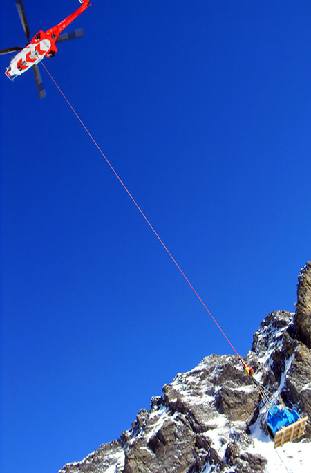

The installation on-site presented definite challenges. The plant, set into a steep hillside at a 2,000-meter altitude, could only be reached by helicopter. This meant personnel, which included a team of eight specialists in servicing rotary units and systems, and materials with weights sometimes exceeding a ton, had to be airlifted. Harsh winter weather conditions were also a factor, as installation was required to be performed from January through March. Lastly, the pumping station’s location itself, a cave only reachable via a 60-meter-long sloping shaft fitted with rails, presented yet another difficulty.

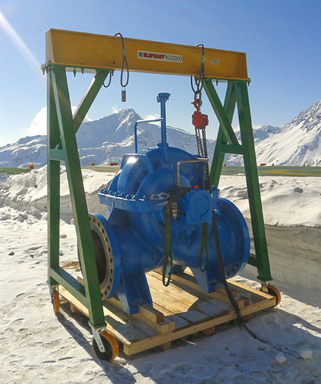

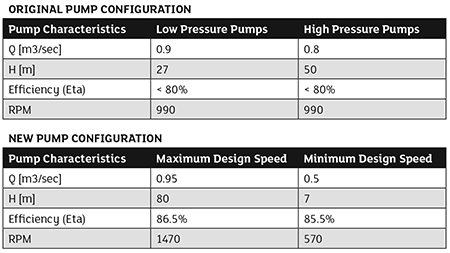

The OEM replaced the four existing horizontal axially split pumps performing water transfer with two high-efficiency enhanced pumping units of the same type, each comprising of a pump, motor, inverter (VFD) and transformer train. In the original configuration, the pumps worked in couples, separately for low- and medium-head pressures and in series for high-head pressures. With the new configuration, the VFD allows the two pumps to cover all the pressure services.
The pumping systems pipework, wiring, bases and supporting structures were also adapted to the user’s specifications. Additionally, the inclined shaft gear (winch and wagon) and the external handling systems were replaced to support the new weight of the equipment (three tons). Finally, the OEM supply included the upgrade of the pumping station’s control systems.

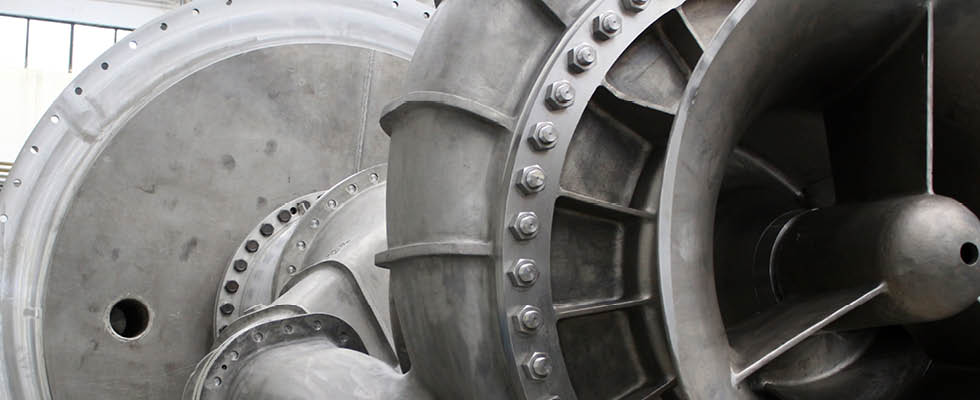

The OEM participated in an energy-saving project at a desalination plant where the end user opted to replace core components of the plant’s primary power-consuming machines—the brine recirculation and seawater supply pumps.
At the time of the project, the pumps in question had been operating for more than 30 years and remained in good condition thanks to the operational and maintenance standards in place. However, considering the progress made in pump design and operating efficiency since the plant’s commissioning, the end user decided to launch an energy-saving project. The outright replacement of entire pumps was not taken into consideration, as it was not financially justifiable. For this reason, the end user decided to focus only on changing the core components of the pumps. As the OEM that originally supplied both types of pumps had shifted its business, the end user searched for another pump manufacturer able to give a new life to its existing pumps.
The OEM conducted an extensive engineering study and proposed two high-tech solutions for the rebowling of the brine recirculation and seawater pumps. The solutions proposed optimized the hydraulics of the pumps while maintaining the existing interfaces and materials. They predicted energy savings substantially higher than the figures requested by the end user.
