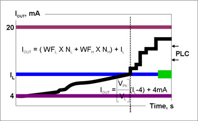

The RMP device continuously monitors embedded acceleration signal using a high-speed peak detector. Using an internal microprocessor, it compares each peak detected against low and high shock threshold levels, calculates RFI, and outputs a 4-mA to 20-mA signal proportional to the RFI. Figure 8 shows a typical trend plot of RFI.
If no peaks exceed either threshold, RFI is simply equal to the peak amplitude detected. Thus, if a data logger is used with the system, trending can be implemented. If any peak in the sample time exceeds either threshold, the processor counts them, applies a weighting factor based on amplitude, and computes RFI. The output of the RMP is typically routed to a meter, PLC, or other device capable of tripping warning and critical alarms based on output. Default values for these alarms are provided with the unit.

shock-fig-7.jpgThe RMP device continuously monitors embedded acceleration signal using a high-speed peak detector. Using an internal microprocessor, it compares each peak detected against low and high shock threshold levels, calculates RFI, and outputs a 4-mA to 20-mA signal proportional to the RFI. Figure 8 shows a typical trend plot of RFI.
shock-fig-8.jpgIf no peaks exceed either threshold, RFI is simply equal to the peak amplitude detected. Thus, if a data logger is used with the system, trending can be implemented. If any peak in the sample time exceeds either threshold, the processor counts them, applies a weighting factor based on amplitude, and computes RFI. The output of the RMP is typically routed to a meter, PLC, or other device capable of tripping warning and critical alarms based on output. Default values for these alarms are provided with the unit.
