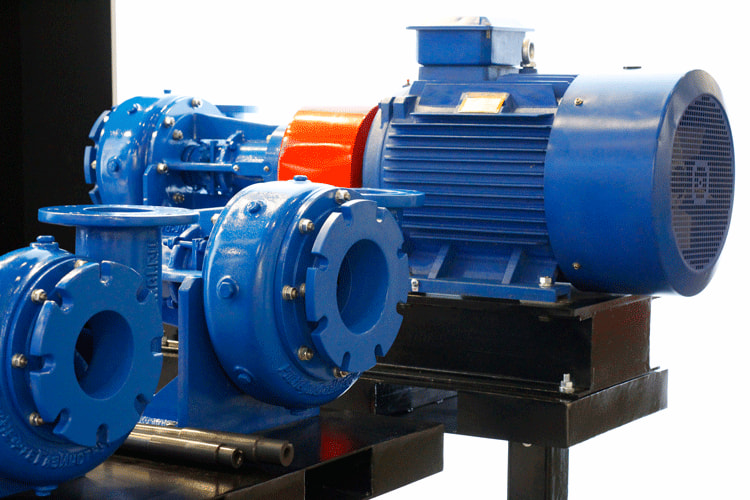

Simple Modifications for Skids
With Environmental Protection Agency (EPA) and Occupational Safety and Health Administration (OSHA) regulations being strict in the industrial and oilfield divisions, every drop of fluid on the ground creates a huge issue. Even with drip pans, users still must clean out and move the leaked product somewhere else. This typically results in the use of oil absorbent rags/towels, absorbent materials sprinkled on the skid or some other form of removal of the leaked product. Building a removable drip pan that can be easily removed allows the end user to empty the leaked product into a containment bucket for safe disposal off-site. This reduces the amount of waste and the additional cleanup required. The removable drip pan also allows the user to be in control of how they discard the leaked material and allows for a quicker cleanup of the site. In turn, this will allow the end user to stay in compliance with EPA and OSHA.
