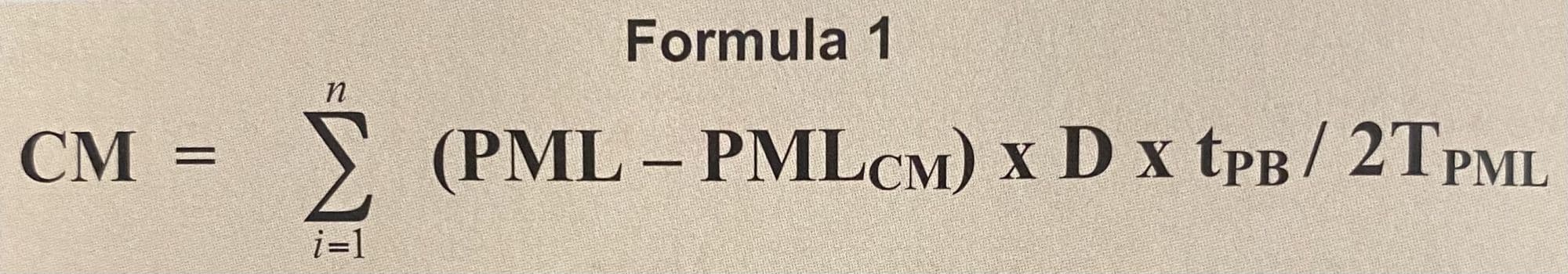

Now that some basic concepts have been covered, let's explore the simplified justification formula. Assume that all of the annualized risk is represented by PML events. Based on this assumption, I propose the maximum amount of condition monitoring equipment justified (CM) is determined by the following formula:
formula 1
Where:
  1. CM is the maximum amount of condition monitoring equipment justified.
  2. PML is the probable maximum loss predicted without condition monitoring. (Include probable losses due to fire and environmental releases, etc.) The equipment OEM is one good source for this information.
  3. PMLCM is the probable maximum loss predicted with condition monitoring. Again, the equipment OEM is one good source for this information.
  4. D is the probability of detecting the machine fault in the primary state.
  5. tPB is the payback period required by management
  6. TPML is the predicted time between PML events. Use five years for unproven, isolated or severe service machines, ten years for typical industrial duty machines and 20 years for proven, light-duty service machines.
  7. Sum these terms for all components in the train or general area to determine the total amount CM equipment justified.
Consider a spared pump example involving two 500-hp spared pumps. No production loss is associated with pump failures. If we only consider secondary damage due to an undetected primary failure, we decide PML-PMLCM is $75,000. Now assume this is an isolated installation, and therefore select TPML of five years, a D of 75 percent, and a management-required payback of two years. This analysis will lead us to the conclusion that an investment of up to $75,000 x 0.75 x 2 / 10 = $11,250 in CM hardware is justified.
