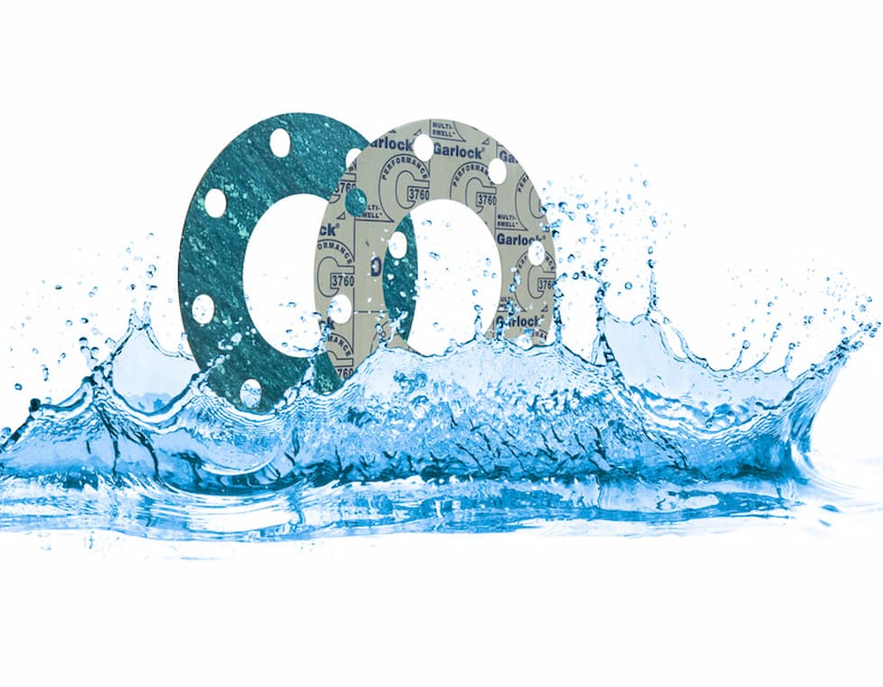

Many nuisance leaks can also be attributed to vegetable or cork fiber gaskets commonly found in gearboxes, inspection covers and pump casings. Vegetable fiber gasketing’s flaw is that it will eventually leak no matter what users do. Since these products are made from plant fiber, consider how a plant takes water from the ground to the top of the plant through tiny “tubes” called the xylem and phloem. When these “tubes” are chopped up to create the sheet material, gaskets end up with millions of tiny leak paths that will eventually allow water, oil or other media to pass through.
As with most things, gasketing technologies continue to evolve. New sealing solutions are designed to eliminate these annoying and costly leaks for minimal additional cost. These products are often designed to be more compressible, which is necessary for gearboxes, covers and casings that tend to be lighter weight castings and/or sheet metal. Improved compressibility, in combination with engineered controlled swell properties, has resulted in gasketing materials that are designed to absorb a small amount of water or oil from the process fluids, expand slightly and create a tighter seal. While the traditional vegetable fiber material may come at a lower cost, it is important to look beyond and consider the cost of the fluids being lost, the slip and fall safety concerns as well as the associated cost of those leaking fluids that find their way into drains where remediation becomes necessary.
