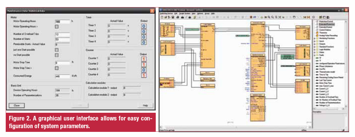

Configuration, Not Programming
Advanced intelligent overload relays have sophisticated yet easy-to-use configuration software that eliminates costly and time-consuming programming. A graphical user interface (see Figure 2) enables users to select applications easily. No programming or complicated configuring is needed. For example, configuring the SMM device illustrated in Figure 2 to sense and report over-current conditions requires just two mouse-clicks.

Figure 2. A graphical user interface allows for easy configuration of system parameters.
