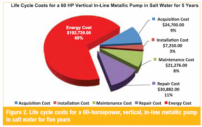

As seen in Figure 2, energy costs dwarf any other expenses. Here, the acquisition cost is only 9 percent of the total life cycle cost of one pump.
This is why the DOE, Europump, and the HI have focused on pump life cycle costs.

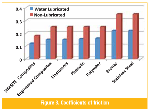

Low Coefficient of Friction
As shown in Figure 3, most composites have a lower coefficient of friction than metallic materials—such as bronze or stainless steel—that have been traditionally used in pumps. Structural graphite composites and engineered composites have the lowest coefficient of friction, lubricated or non-lubricated. The low coefficient of friction reduces the friction losses of the liquid being pumped, which allows for an increase in efficiency and a reduction in energy consumption.
Composite coatings have been used to coat pump casings, which not only protects the casings against corrosion and erosion but also smooths the rough surfaces, reducing friction and increasing efficiency. Some studies have shown that efficiency can be improved by as much as 2 to 3 percent by using composite rings, guide bearings and coatings.

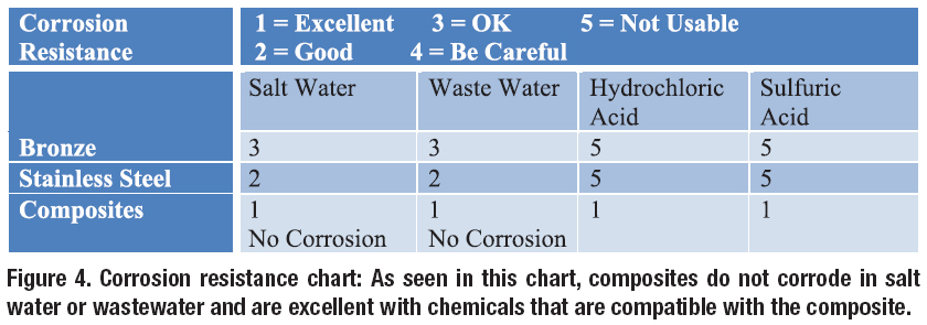

Since many composites are impervious to different corrosive environments, they will not corrode, or erode. Although composite wear components will reduce energy consumption for all pumps, including all fresh water services, the greatest savings occur in corrosive environments such as salt water, wastewater, chlorinated water and chemical processing because the composites, in many cases, will not corrode at all.
When metallic pump parts begin to wear from corrosion, pump efficiency drops drastically. The life cycle of the pump is often reduced to months instead of years.

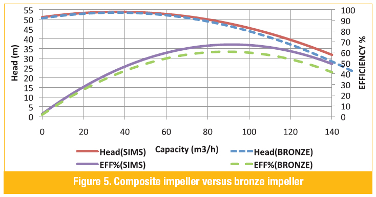

Composite Versus Bronze Impeller
Figure 5 shows that changing a bronze impeller to a structural composite impeller increased efficiency 15.8 percent. The efficiency on this 20 kilowatt pump (26.8 horsepower) went from 57 percent with a metallic impeller to 66 percent with a structural composite impeller—an increase of 9 points. At 0.11 cents per kilowatt hour this translates into a savings of $2,218.00 per year, per pump.
After only one year of service in a corrosive salt water environment, the bronze impeller began to corrode, further reducing efficiency. Depending on the service, the temperature of the salt water and how the pump was operating, the efficiency will be reduced by as much as 5 to 7 percent or more, resulting in additional energy costs.
Upgrading to a structural composite impeller will not only increase efficiency 15.5 percent from the start but will also prevent the losses in efficiency as a result of corrosion resulting in a total saving to the customer of more than 20 percent, which results in a savings of $4,155.00 per year per pump.
