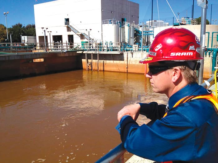

Image 1. In 2013, representatives at a municipal water district in California met with Cortech Engineering to find a solution to the high cost of pump replacement for their water reclamation facility. Local refineries rely on the municipal water district to send up to 5 million gallons of reclaimed water per day to be further treated and used for boiler feed and cooling tower applications. (Images courtesy of BJM Corp.)- Endurance for continuous duty. Each microfiltration backwash waste pit utilizes a single submersible pump operating 24/7 continuous duty, so the water reclamation facility needed a high-endurance submersible pump that could withstand the continuous running condition.
- Resistance to abrasive solids. The water reclamation facility needed submersible pumps that could pump the particulate without quickly wearing out. Frequent pump failure from abrasion and erosion had been causing unwanted maintenance and downtime costs.
- Pump reliability. The previous pumps had failed because they were not designed for the long run times or for effective handling of abrasive slurry, so the reclamation facility needed submersible pumps that would perform reliably for the specific application.
