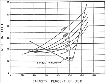

"Stable" Window of Operation
In 1985, Lobanoff and Ross (1) provided the graph shown in Figure 2. It provides not only a minimum capacity, but also a maximum capacity for "stable" pump operation. It represents test results of a 4 in (discharge) pump with eight different impellers. The onset of instability was determined by measuring pump vibration. The minimum flow values obtained from this graph compare favorably with Dubner's water values (Figure 1).
Figure 2. "Stable" Flow Range vs. Suction Specific Speed for a 4 in Pump

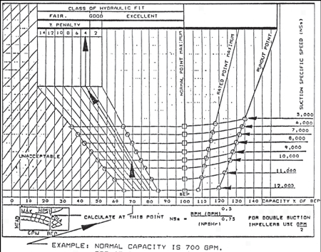

Figure 3 is an adaptation of the Lobanoff‑Ross graph. Dick Allen developed the graph in 1990 to assist in evaluating pump bids. It provides a method for evaluating the size of the stable window by penalizing pumps that have smaller stable windows (higher suction specific speeds).
Figure 3. Centrifugal Pump Stable Window of Operation Based on Suction Specific Speed (Courtesy Dick Allen)
The penalty values are arbitrary, based on the judgment of the graph's author, and may be revised to suit the experience and philosophy of a given company.
Key points made by this graph:
1. Do not buy a pump to operate continuously at a capacity within the "unacceptable" area (roughly any capacity less than 50 percent of Qbep).
2. To operate in the "excellent" hydraulic range, capacity must be higher than the "penalty" range (roughly 75 percent of Qbep).
3. Do not buy a pump to operate continuously at a capacity higher than Qbep.
4. Do not buy a pump rated at a capacity higher than about 115 percent of Qbep.
