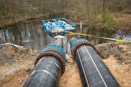

In a residential area outside Baton Rouge, La., heavy winter rains flooded a swollen levy and lock drainage system, resulting in more than 10 feet of floodwater that threatened homes and residents. For almost two weeks, residents scrambled for sandbags to keep the encroaching water from their homes. However, with the ongoing danger from additional winter storms, the water was not draining from the area fast enough.
Local parish officials reached out to a liquid handling solution provider to help design a system that would accelerate the draining process while protecting homes and infrastructure from the floodwaters. Within hours, this provider designed a solution to meet the critical needs of the community.
The system used two floating pumps stations. Each station consisted of a 42-inch, two-stage high-efficiency, self-contained axial flow pump that was capable of producing the high water flows that are ideal for flood control and large dewatering projects. It delivered maximum flows of up to 68,500 gallons per minute and produces a maximum head of 27 feet.
The two floating dewatering systems removed more than 96,000 gallons per minute of floodwater from the aging system of levies and locks. They operated 24 hours per day for three consecutive weeks and reduced the water levels from 14 feet above flood stage to normal.

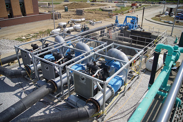

To tie new construction into the existing wastewater infrastructure, an expanding wastewater treatment plant required a screened sewage bypass of up to 75 million gallons per day. The project was time sensitive and offered only a small footprint for bypass pumps to operate effectively.
One of two floating pump stations that reduced flood water levels.The plant’s contractors selected a two-pump bypass solution consisting of a primary system with two large, self-priming centrifugal trash pumps and one smaller, self-priming trash pump to manage the 75 million gallons per day. A backup system using an additional large trash pump was also provided.
The large, centrifugal pump is one of the largest portable, diesel-powered, self-priming centrifugal pumps available for rent—a 30-inch suction x 24-inch pump that delivers up to 28,000 gallons per minute of pumping and up to 96 feet of head. The smaller pump is a self-priming centrifugal pump with an 18-inch suction and 16-inch discharge that delivers a maximum of 16,000 gallons per minute of pumping and up to 200 feet of head. These pumps are usually mounted on a skid and feature a standard vacuum priming system that allows them to run continuously, unattended and even run dry.
Using three pumps with one backup for the bypass was cleaner and easier to maintain within the tight space constraints at the plant, and it used less diesel fuel throughout the continuous month-long bypass. Because of the liquid handling solution providers’ practice of stamping the high-density polyethylene (HDPE) to secure the welds and hydro-testing the system, the successful bypass was spill-free, cutting the plant contractor’s costs.

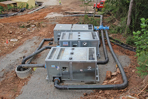

Pump volume was monitored by sound-attenuating pumps with an alarm agent.To minimize the impact on residents in nearby neighborhoods, noise and environmental precautions were also taken. Sound attenuating pumps were used, and every bypass was designed with a backup pump and a special telemetry alarm agent to automatically alert individuals via cell phone if the system required immediate attention, such as when the volume rose too high. Before the sewage began to run through the bypass, all the 12-inch and 18-inch HDPE pipe was hydro-tested with clean water to ensure that no leaks were present.
