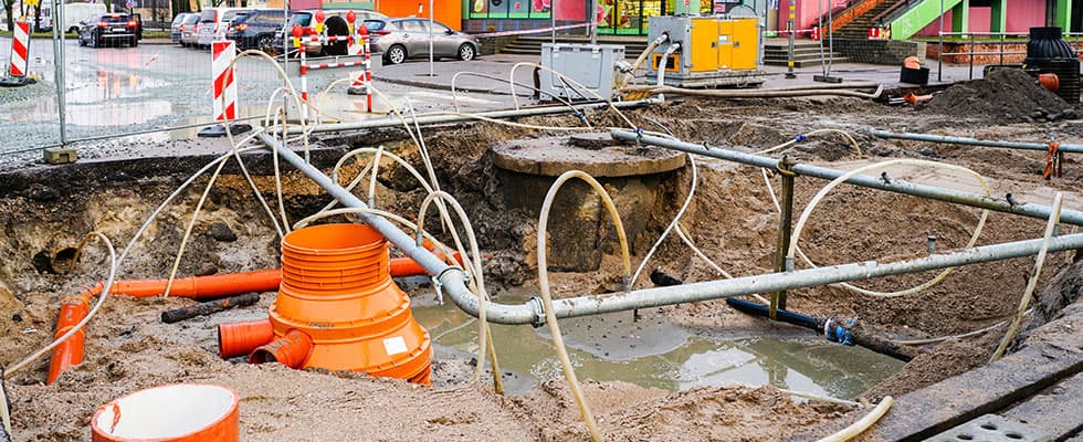

A wellpoint dewatering system consists of a series of shallow, small diameter wellscreens placed at predetermined intervals, typically around the perimeter of an excavation or alongside a trench. A vertical riser pipe connected to the wellscreen functions like a straw to drain water from the soil. The riser pipes are connected to a horizontal pipe, called a suction header pipe, which connects to a pump. To prime the system, the pump is filled with water. As the pump expels the water, a vacuum is created. Water is then removed from the ground through the resulting suction and transported to a discharge point.
Valved swing hoses attached to the riser pipes and suction header pipes are used to “tune” the wellpoints by limiting the amount of air that moves through them.

Wells are often installed manually with a jet rod. If an excavator is available, wells may be installed using a jet pump or an auger attached to the excavator, or with a combination of drilling and jetting. A jet casing pipe may be used in silty soil to keep the hole open long enough to place a clean sand filter around the wellpoint screen.
