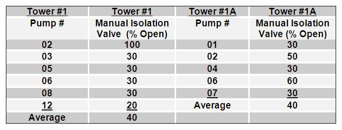

Depending on flow demand, typically 11 pumps operate in the winter and 15 in the summer. A 460-volt, 400-horsepower motor running at 1,180 rpm drives the pumps to deliver 6,875 gallons per minute (gpm) at 180 feet, at the original design point. The verticals are two-stage pumps with discharge isolation valves that are 40 percent open, on average.

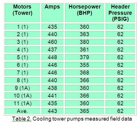

To satisfy varying demand, the pumps are turned on and off manually. The header pressure ranged from 60 to 70 psig (1-year trend).
Typically, the pressure and flow was around 68 psig and 90,000 gpm during the summer months and 62 psig and 60,000 gpm during the winter. Also, the system static head was approximately 80 feet.

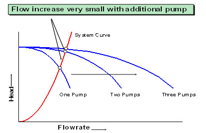

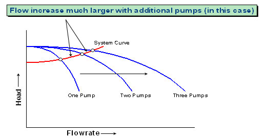

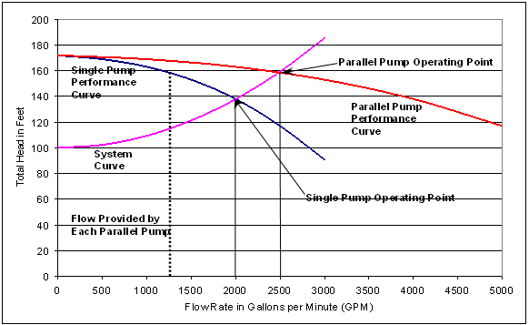

Note: In parallel pumping systems, when turning on additional pumps, more incremental flow is realized in a high static head system than in a low static head system.
When parallel pumps are turned on in sequence, the system pressure (on the composite pump curve) increases while the incremental flow increase is less for each new pump (n + 1) that is energized or vice-versa (n – 1).
Therefore, each pump that is turned off allows the remaining pumps to run farther out on their individual pump curves (see Figure 1).

| Table 1. Observed valve position |
Table 2. Cooling tower pumps measured field data |
The cooling tower system optimization project is a classic example of how a focus on efficiency has driven savings in energy consumption. It illustrates a common practice of over-sizing the pumps to meet system demand. The discharge header and piping have a relatively small friction loss, compared to the pump’s design head, requiring that pressure be bled off, across the isolation valve, to keep the pumps from running too far off the end-off the pump curve, which resulted in motor trips. By trimming the two-stage pumps’ impeller diameters to minimum and fully opening the discharge valve(s), each pump could operate closer to best efficiency point (BEP) and deliver approximately 2,000 gpm extra capacity.
