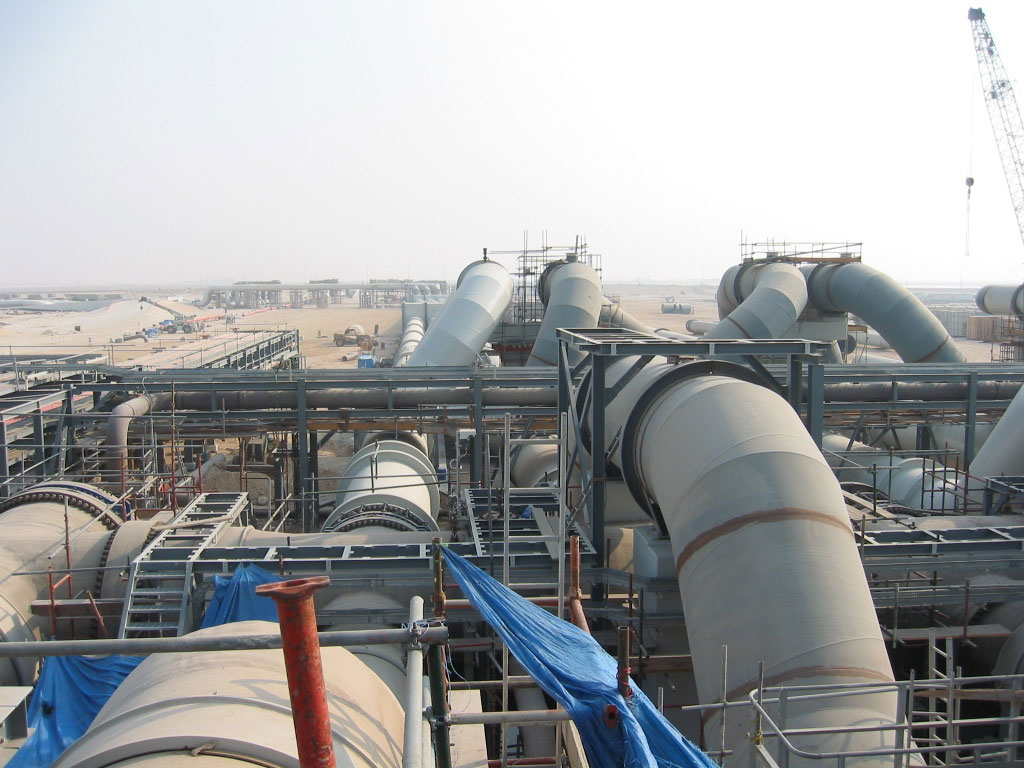

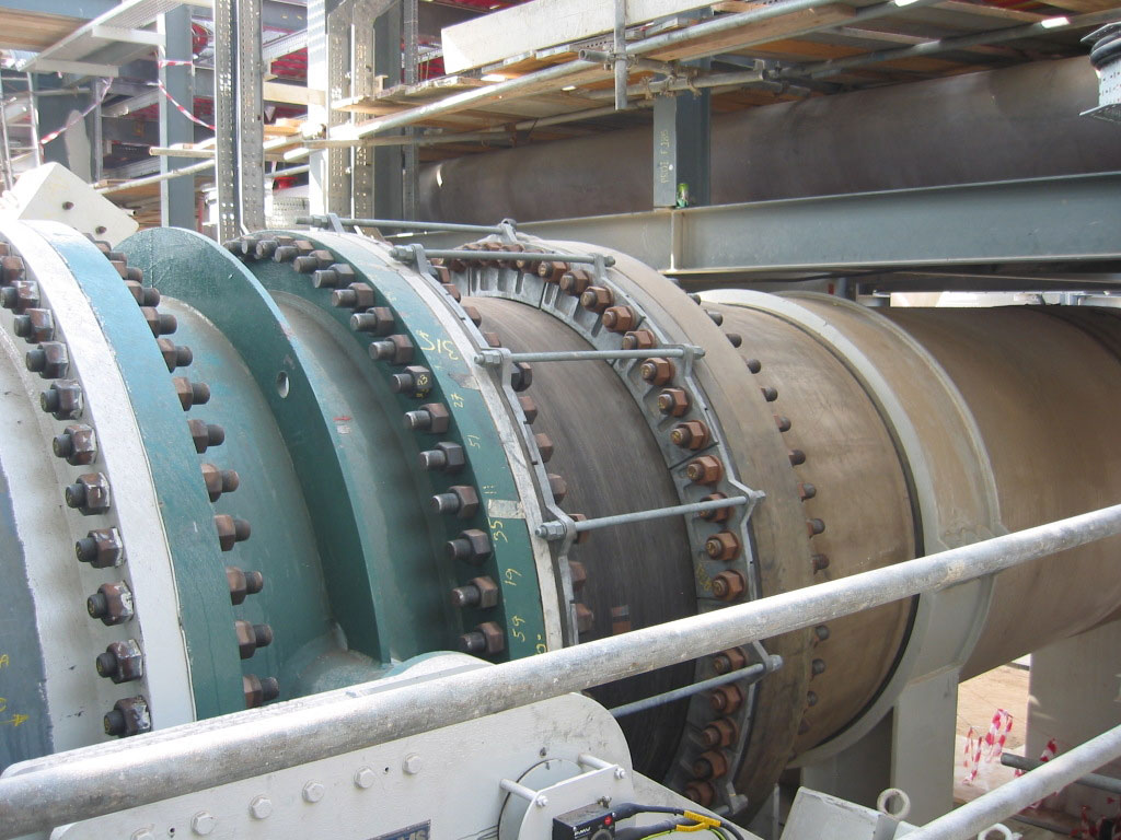

A Common Cooling Water Project with a capacity 1.32 million-gpm provided the main source of cooling water to a whole industrial complex. It had a network of large diameter FRP piping that distributes the cooling water.  Nearly 100 large rubber expansion joints in sizes 60-in (DN 1500) to 144-in (DN 3600) were incorporated throughout the system. Each valve location required a dismantling joint.
Figure 1. Overview of FRP piping complex
Figure 2. Typical expansion joint installation
The expansion joints were designed to compress 2- to 3/8-in (60-mm) on itself, functioning as a dismantling joint, while also accommodating the large thermal movements in the system.  These very large parts had to be designed for a test pressure of 200-psi (13.5-bar).

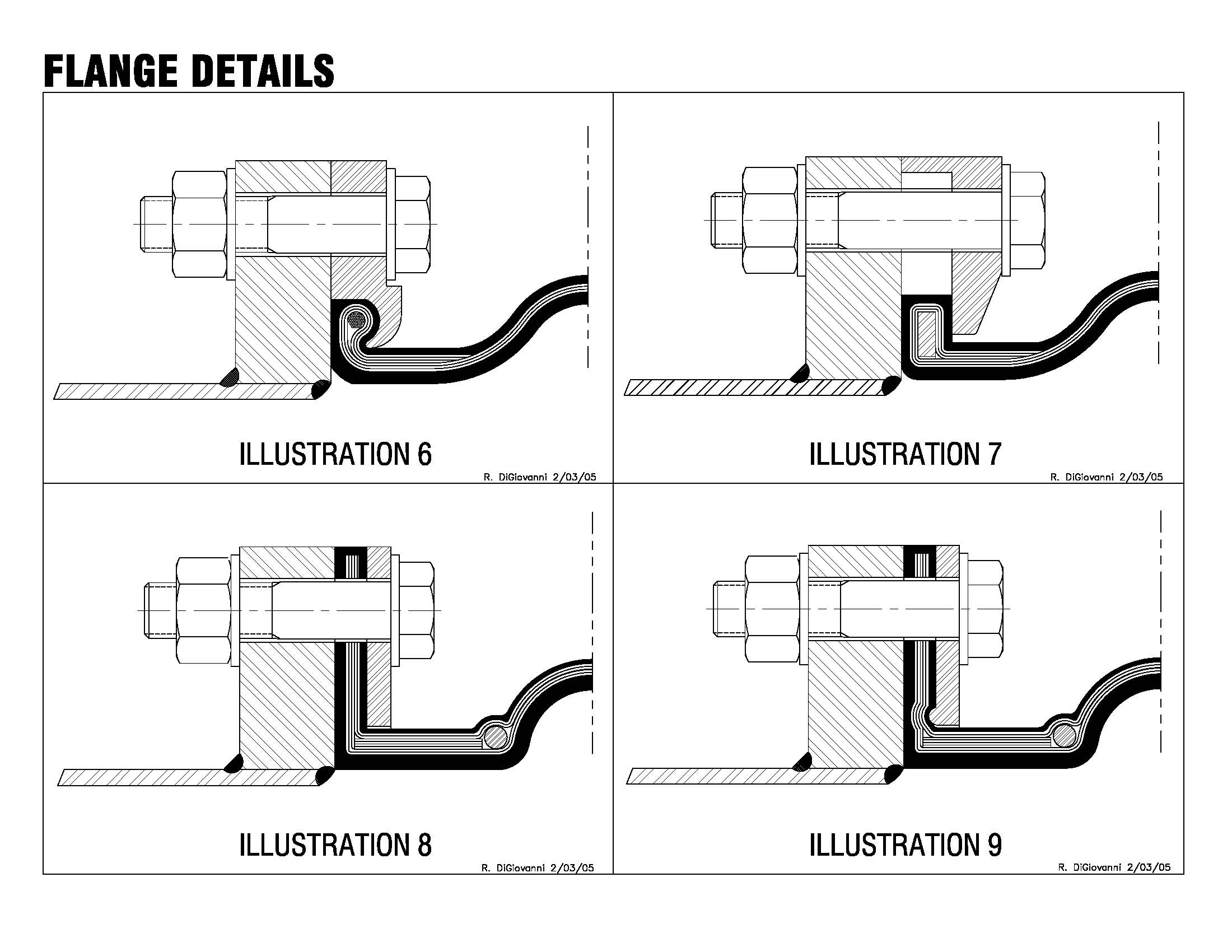

The higher sealing requirement was the primary design focus.  The body of the expansion joint was reinforced to handle the high pressure. Since the limitation to previous designs had been leakage at the flange, a review of flange designs was undertaken. It was clear that different flange designs had different advantages and disadvantages. The goal was to take the best features from various designs and develop an optimal design.
Figure 3. Flange designs for FRP piping system
Advantages and disadvantages of the designs shown in Illustrations 6, 7, and 8 of Figure 3 were considered. Analyses resulted in the use of a flange design that incorporated the pressure point feature of the solid floating flange design shown in Illustration 6 with that of the full rubber design of Illustration 8.  This new design is shown in Illustration-9 and incorporates a bulb in the retaining ring.
The bulb focuses a sealing force on a relatively small area beneath the bolt circle of the rubber flange. As a result the bolt torque is minimized and a higher-pressure rating can be achieved. The new design also does not require periodic retorquing of the bolts.
The new design also requires half the bolt torque that the flat-faced design required for the same test pressure.  Pressure ratings that were previously un-obtainable now are obtainable.  Flange leakage and the maintenance intensive task of periodic retorquing of the bolts also was no longer a concern.
