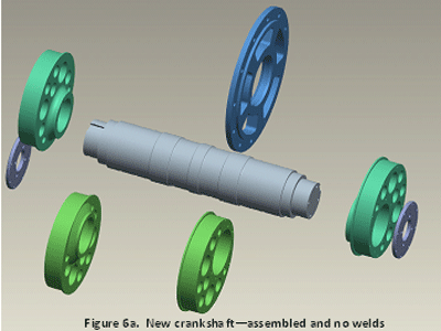

The case for welding or casting a crankshaft is arguable. While the cast crankshaft is strong and sometimes quite reliable, it is easy for casting anomalies like porosity and inclusions to be undetectable in inspection. Welded crankshafts always have a problem with the weld of the cams so close to a large diameter change, which can create stress concentration-induced problems. One way of avoiding both these problems is to have a modular crankshaft, which is assembled and disassembled without any welding or the need for subsequent heat-treating during manufacturing. All the crank components would be assembled from high quality forged parts that will last longer in any application and are unlikely to ever fail under normal or extreme conditions so long as the crankshaft is supported properly. (Figure 6 shows close bearing proximity to cams and spherical bearings.)
New Crankshaft - assembled and no welds
New crankshaft - assembled and not welded

A fully assembled crankshaft is the best and only way to install multiple bearings close to the cams. Even though there is minimal flexure in this design, spherical bearings eliminate stress concentration or point loading. With cam to bearing distances no more than 10 in, the bending moment on a quadraplex crankshaft will be one quarter that of the triplex or five cylinder pump.
