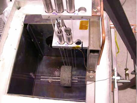

The coefficient of thermal expansion (CTE) measurements were made on the new material bearings using a custom dilatometer system as shown in Figure 4, which is based on ASTM E-228-06. The linear variable differential transducers were positioned to measure the displacement of the outer diameter, thickness and length as the temperature was ramped from 22 degrees C to 600 degrees C at an average rate of 3 degrees C per minute. The dimensions of the bearings made from the new CMC were approximately 105 millimeters (outer diameter), 54 millimeters (inner diameter) and 51 millimeters long.![](https://www.pumpsandsystems.com/sites/default/files/figure4.jpg)

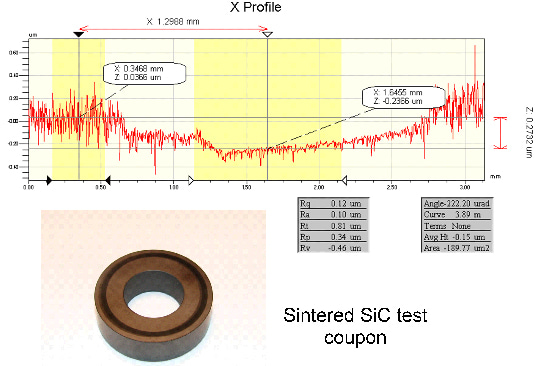

Water lubricated sliding wear tests were performed according to a modified version of ASTM D 3702-94 to simulate sleeve bearings in magnetic drive pumps. The test specimens are shown in Figure 6, where a disc specimen made of the new material rotated against a stationary specimen made out of either sintered SiC or 1018 hardened steel. The test procedure involved increasing the speed of the rotating specimen in steps up to 900 rpm and then back to zero at a specified normal load. The specimens were immersed in water that was maintained at an ambient temperature, and the friction coefficient was continuously monitored and plotted against the rotational speed.![](https://www.pumpsandsystems.com/sites/default/files/figure6.jpg)
