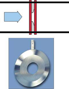

Characteristics of the inserted elements vary. The orifice plate is the most common, being greatly studied, inexpensive and available in a variety of materials. Rangeability is usually less than 5:1. Accuracy tends to be 2 to 4 percent of full scale. Retaining good accuracy requires maintaining a sharp edge to the upstream side of the orifice plate, which degrades with wear. Pressure loss is high relative to other DP elements.

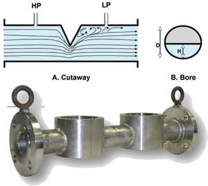

The wedge consists of a V-shaped restriction molded into the meter body. In profile the wedge looks like a segmental orifice plate to the incoming fluid, but it is more expensive than an orifice plate. This basic meter has been on the market for more than 40 years, demonstrating its ability to handle tough, dirty fluids. The slanted faces of the wedge provide self-scouring action and minimize damage from impact with secondary phases. Rangeability of 8:1 is relatively high for a DP element and accuracies are possible to ± 0.5 percent of full scale.
Wedge
Wedge
For especially abrasive or corrosive liquids, the wedge flowmeter can come with remote seals that effectively isolate the metered fluid from the tubes running to the DP transmitter.

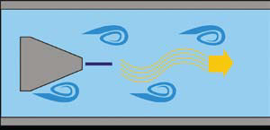

Place a blunt obstacle within a fluid pipeline, and the fluid will alternately produce whirling vortices on either side of it. The spacing between the vortices remains constant, regardless of the fluid velocity. Piezoelectric or capacitance sensors typically count the pressure oscillations caused by the vortices. The vortex shedding frequency provides a measure of fluid velocity.
Vortex
Vortex

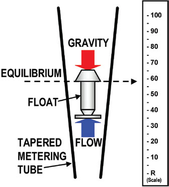

Commonly known as rotameters, these devices provide practical solutions for many flow metering applications. They are simple and inexpensive, performing as well or better than many high-tech flowmeters on the market.
Every rotameter basically consists of two components: a tapered metering tube made of glass, metal or plastic and a float that rides within the tube. These components come in a wide variety of shapes, sizes, weights and materials of construction, making them adaptable to a wide range of application needs. They are easy to install and maintain, but must be mounted vertically and plumb. Some designs can handle high pressures and viscosities. Today, most manufacturers have taken all the factors and data involved in sizing a rotameter and incorporated them in a sophisticated software program.
Rotameter
Rotameter
Accuracy, however, is relatively low (±2 percent) and depends on precise knowledge of the fluid and process. Rotameters are susceptible to vibration and plugging by solids, and are affected by density and temperature changes. They apply primarily to flow rates below 200 gpm and pipe sizes less than 3 in.

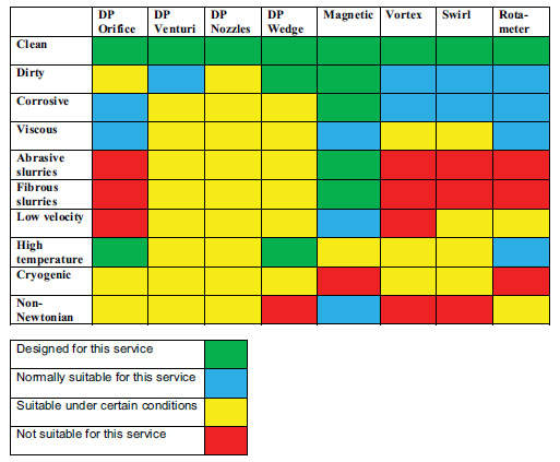

Table 1 provides selection information based on the nature of the liquid to be measured. It can be used as a rough guide, but the specifics of an application will narrow the selection further or suggest exceptions.
Volumetric flowmeter selection chart for liquids
Table 1. Volumetric flowmeter selection chart for liquids
