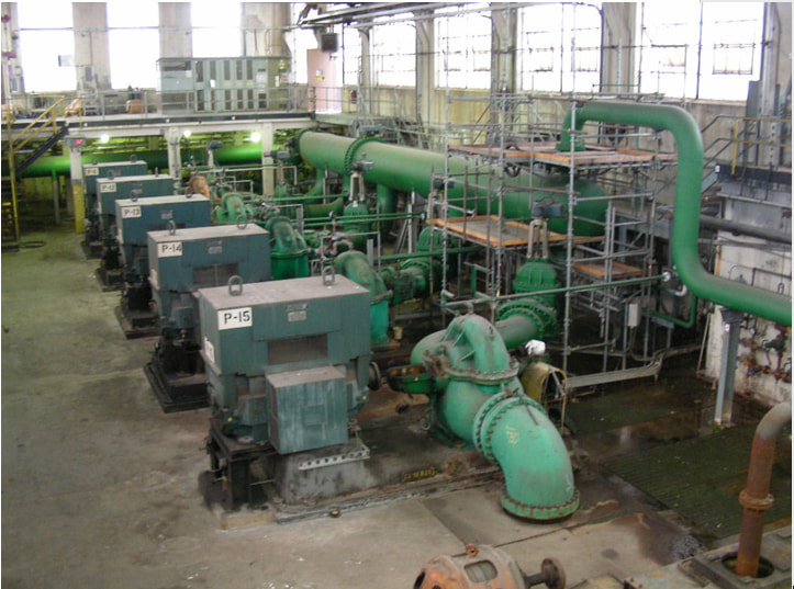

On the shores of Lake Michigan, two stations contain cooling water pumps that feed water to BP’s Whiting Refinery. The No. 1 water station contains four IR 24 HV pumps—large, single-stage, double-suction, horizontal split case pumps. The four pumps in station No. 1 (P-11, P-12, P-13, and P-14 in Figure 1) are unique because they were designed with a bottom-suction configuration.
Image 1. Four IR 24 HV bottom-suction pumps and one IR 24 FV pump (P-15) in the refinery's water station on Lake Michigan Image courtesy of BP

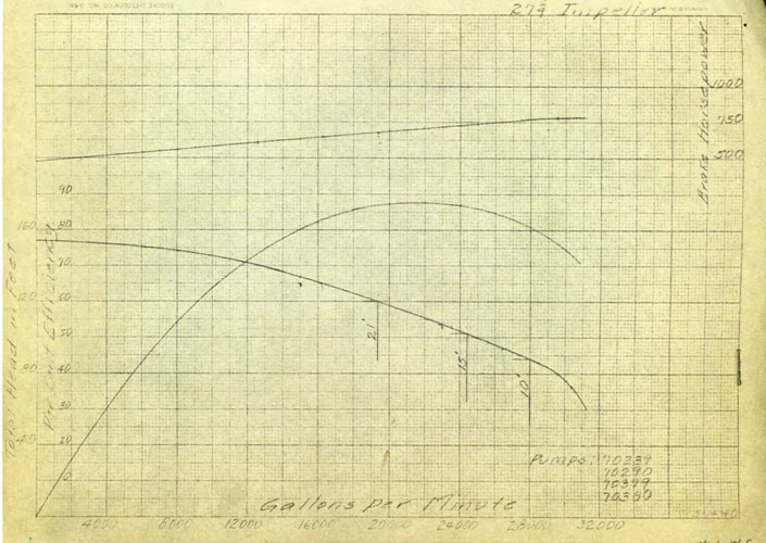

The rotating equipment engineers at the refinery wanted to better understand the operating characteristics of these pumps, which were originally built by Cameron in 1928. Because they were installed so long ago, no net positive suction head (NPSH) data were available and the pumps’ best efficiency point (BEP) was not known.

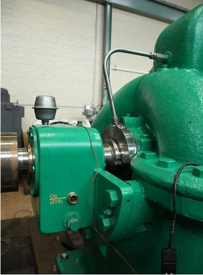

The refinery’s rotating equipment engineers first asked the service center engineers about redesigning the bearing housings. The original bearing housings were 2.5 feet long with spherical shell journal bearings that were hard to machine and made proper alignment difficult. More important, redesigning the bearing housings would help reduce the weight on the external bearings.
Because the bearings were an obsolete design, the service center engineers evaluated new bearing configurations at the request of the refinery. Axial thrust and bearing loads were reviewed to determine the best bearing design. Modifying the bearing design gave the refinery another option to upgrade from packing to mechanical seals, which would provide an added benefit of reducing leakage and decreasing energy consumption. The evaluation of upgrading to mechanical seals prompted a review of shaft deflection, or bend in the shaft. Mechanical seals can accommodate a limited amount of shaft deflection, so the shaft would need to be redesigned to work with the mechanical seals.
Once the engineering review was complete and all the modifications were agreed upon, the service center went to work. The shaft was modified to a stepped design and the distance between the bearings was shortened to reduce deflection at the seal faces. The sleeve bearings were removed and ball bearings were put in to handle the axial thrust of the rotor, therefore stabilizing the shaft and lowering vibration.
New mechanical seals were installed along with newly manufactured bearing housings (see Figure 2), which were fabricated at the service center. The service center manufactured the new bearing housings from a steel plate using its five-axis computer numerical control (CNC) machine.

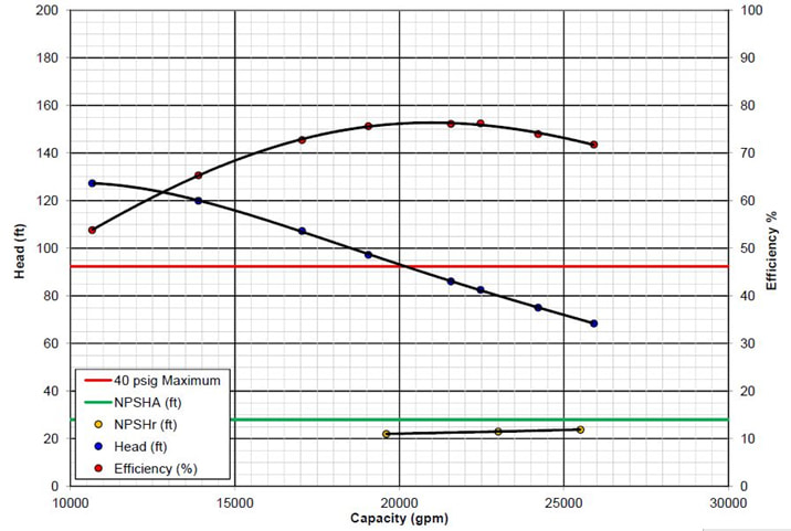

Test Results
Figure 3. Pump performance curve Image courtesy of Hydro Performance Test Lab Inc.
The tests revealed that the pump can be operated to the right of BEP and still stay within the net positive suction head available (NPSHa). The data (see Figure 3) indicated that one pump operating at a higher capacity can eliminate the need for three pumps operating at reduced capacity. These findings suggest significant potential energy savings for the refinery and may enable it to run just one of these pumps in each water station during the winter months and two pumps in each water station during the summer months. The performance testing went a long way toward allowing refinery engineers to shut down unnecessary water pumps, and the modifications made to this pump will allow engineers to run it more reliably.
