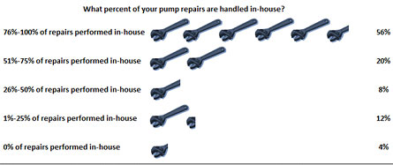

Each facility is different. Figures 1, 2 and 3 are results of a survey of more than 100 industrial pump users, asking at what level of cost do they repair a pump versus replace it (Figure 1); how they normally do pump repairs, in-house versus outside (Figure 2); and their preferences on individual parts versus repair kits (Figure 3).
Do a facility’s pump maintenance practices and preferences look like those shown in Figures 1 through 3? The decision to repair or replace is made on a case-by-case basis, but with the tools, parts, kits and expertise available from original manufacturers and local stocking distributors, end users will find rebuilding pumps is normally a cost-effective way to keep processes operating efficiently.
