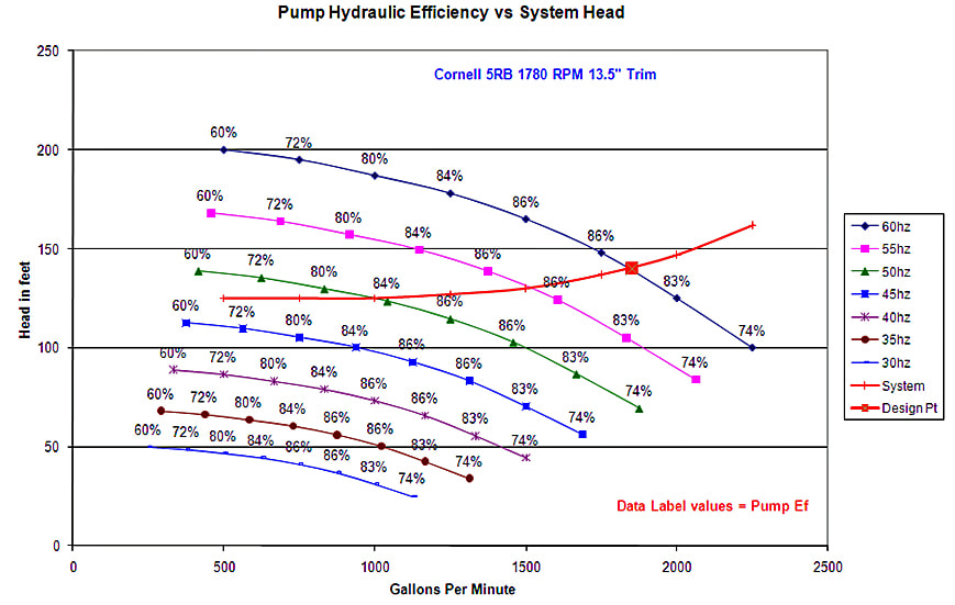

Figure 2 represents the types of charts shown by the tabs (“Pump Head” tab through the “Cost per 1000 Gal” tab) on the site. The one shown is the pump hydraulic efficiency versus system head across the range of flow. It also shows the slope of the efficiency isomers as pump speed (in hz) is reduced and how they intersect the system curve.
This particular pump has a hydraulic efficiency of 85 percent at the design point (full flow) and maintains an efficiency of approximately 84  percent at minimum flow. Intermediate flows peak at 86 percent. This represents an excellent range of efficiency and will have a large impact on energy savings and the cost of operation. The slope of the efficiency isomer is also important. At 1,000 gallons per minute, the efficiency of the 60 hz curve is 80 percent. However, at the reduced speed required by the system curve, efficiency increases to almost 84 percent due to the leftward migration of the 1,250 gallons per minute efficiency point.

Tabs 3 through 6 show the same system curve, frequency curves and design point. The difference is the data label values. The “Pump Head” and “Pump BHP” tabs show the head produced and BHP required at various flow and frequency points. For the example, the BHP ranges from 34 horsepower to 76 horsepower across the range of flow. It also shows a 25 BHP reduction at 1,000 gallons per minute versus control valve operation. The “kW per 1000 Gal” and “Cost per 1000 Gal” tabs show the power and cost per thousand gallons pumped. The cost per 1,000 gallons pumped ranges from 0.051 to 0.057 cents. All the tabs show an operating range of 10 hz from minimum to maximum flow. This is more than adequate to provide stable operation and reduce hunting and over reaction to flow changes.
