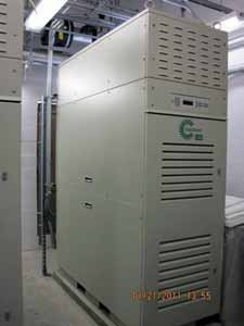

Now, thanks to a project that will implement energy and environmental reform, Pittsfield is about to earn another notable distinction: a city at the vanguard of the green movement. Pittsfield is in the process of constructing an upgrade to its wastewater treatment facility, which will feature a combined heat and power (CHP) system, using three 65-kilowatt rated microturbines for a total rating of 195 kilowatts. The microturbines will be fueled by the treatment facility's digester gas, which is a methane-based byproduct derived from its wastewater sludge treatment process. The digester gas is a biofuel and a renewable energy source.

The design for the upgrade to Pittsfield's wastewater treatment facility has a number of features, including a brick-and-block building to house the entire CHP system, space provisions to allow for a fourth microturbine should the city decide to expand and the furnishing and installing of electrical systems for interconnection of the CHP generated power for use within the entire treatment facility.

Under the proposed CHP system, the digester gas will be sent through a fuel gas conditioning system that removes contaminants from the digester gas and boosts the gas's pressure to the microturbines. The target contaminants of the fuel gas conditioning system include water vapor, hydrogen sulfide and siloxanes—silicone-based compounds contained in many health and beauty care products.
The conditioned digester gas will then be used to fuel the microturbines, which will generate heat and electricity to meet the plant's base-load demands. The waste heat in the exhaust of the CHP system will be used in a heat exchanger to produce hot water. This hot water's purpose is to heat the sludge in the primary digester and serve as building heat in the digester building.
