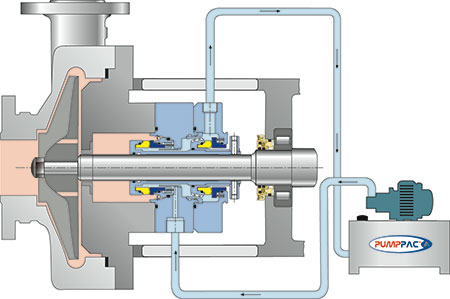

Advanced Sealing for Process Pumps
Pumps used in brewing processes use face seals that are classified as either single, shown in Image 2 with American Petroleum Institute (API) Flush Plan 03, or dual mechanical seals, shown in Image 3 with a cartridge-style dual mechanical seal and API Flush Plan 54. Between 20% and 30% of all brewery pumps will use dual seals for pumping services such as hot wort, mash, kettle and adjunct as well as clean-in-place (CIP) pumps. All seals require either a thin film of water or gas to prevent face-to-face contact and seal overheating. But aside from the 9% average yearly improvement in WUR, a further 10% reduction in WUR can be achieved by modifying and upgrading the traditionally employed seal piping plans in just 25 of the many pumps found in a brewery.
Dual seals cannot function without a secondary fluid acting as a lubricating buffer or barrier to provide both fluid film face separation and cooling. API Plan 55 is used on dual seals at a flow rate of 1.5 gallons per minute (gpm) to provide a buffer fluid of clean water between the inner and outer seal faces (Image 4). However, where Plan 55 usually discharges its buffer fluid to drain, the elimination of flow-to-drain on just 25 pumps will reduce the WUR by roughly 10%, based on data averages found in the BIER benchmark study.
Accordingly, the WUR reduction strategy is to use a water management system instead of the API Plan 55 depicted in Image 4. Water management systems (Image 5) are a modified API Plan 53-A: They are closed systems designed to eliminate the need for operator intervention to maintain the seal pot. The clean water is isolated by a seal support system and recirculated by an internal flow inducer and/or through thermal convection. This means that city water is not lost to the drain—moreover, mean time between failure (MTBF) is extended because each pump is regulated separately. An optimal barrier fluid pressure is chosen to ensure that a clean fluid film exists at all times between its sets of seal faces.
Pressure optimization of the process fluid is required because mash and wort are known to be abrasive. The inner seal faces are precision lapped to one helium light band with an inner seal face rotating against a stationary face. The face set is spring-energized and hydraulic closing forces with properly engineered sealing pressures divided by mean face velocities (p/v ratios) will create a thin fluid film. If the city water buffer enters at a pressure lower than the process fluid, an abrasive process liquid is likely to intrude and establish the fluid film. This means the process fluid eventually cross-contaminates the secondary buffer seal water, which is why it cannot be reused in the seal water loop and, instead, is discharged to the drain. However, by increasing the pressure of the secondary seal water, clean city water becomes the fluid film, which increases the life of the mechanical seal. This requires provisions to pressurize each application differently at each pump. Individual pressurization capability is the primary difference between API Plan 55 and API Plan 54.
