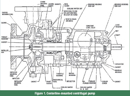

Figure 1 shows a horizontal, centerline‑mounted, API 610‑type centrifugal pump. The liquid end of the pump is to the left. The suction nozzle is also to the left. The impeller faces left. The "eye" of the impeller is that circular entrance to the impeller. Just to the right of the eye are the impeller vanes. It is at the leading edges of these vanes that cavitation will first appear.

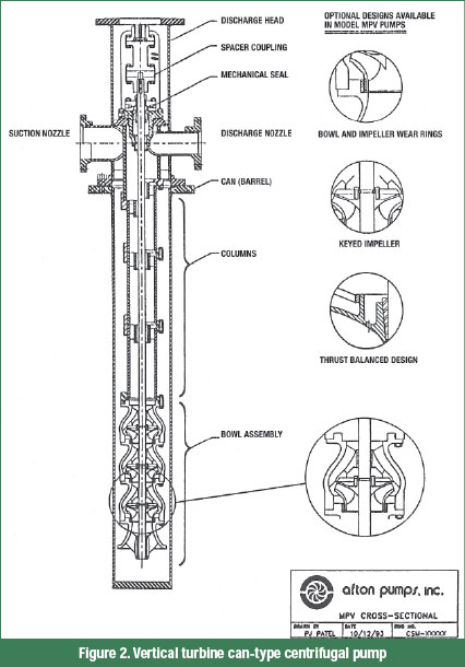

Figure 2 is a vertical turbine, can‑type centrifugal pump. All impellers face downward. The first‑stage impeller is at the bottom. It is the first ­stage impeller that will cavitate if suction pressure is insufficient.

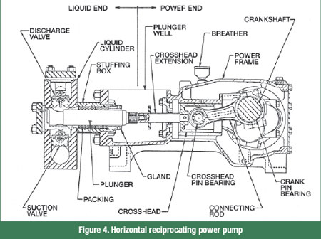

Figure 3 is a horizontal reciprocating power pump. The liquid end is to the left. The suction valve, being merely a check valve, must be opened by suction pressure. If the suction pressure is not sufficiently above vapor pressure, the pumpage will flash as it flows past the suction valve, or flashing will occur at the face of the plunger as it moves to the right on the suction stroke.

Noise is a common characteristic of a pump suffering from insufficient NPSH. The noise is greater if the pumpage is cool water. Centrifugal and rotary pumps emit a crackling sound-as if the pump were pumping gravel. Cavitation in a reciprocating pump causes a knocking sound. In a power pump, the shock wave travels through the plunger, extension and crosshead, and emanates from the power end, often causing an operator or mechanic to incorrectly diagnose the problem as a loose rod or a chipped gear tooth.
