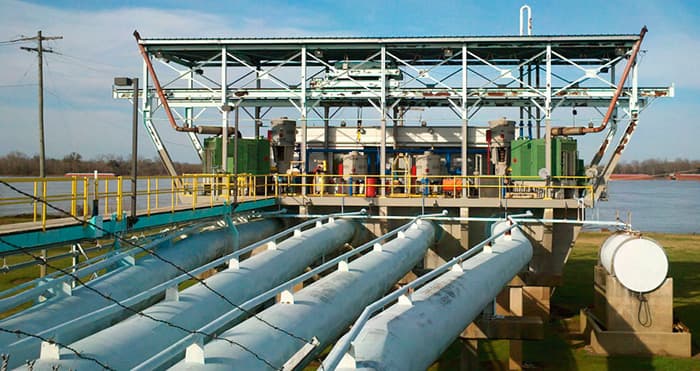

![Image 1. Pump motors and engines are shown in an outdoor pumping station inside a Mississippi River levee, before the addition of eddy current drives.](/sites/default/files/0316/2012-02-06_15-36-46_326.jpg)
1. Installation at a Mississippi River Levee
A freshwater supply district in Louisiana operated a pumping station originally built in 1954 with three pumps. A fourth pump was added in 1960. The pumps draw water from the Mississippi River and discharge on the other side of the levee into the adjacent bayou. All four of the vertical axial flow pumps were equipped with a constant-speed electric motor drive, with two having an alternative to operate the pumps with diesel engines through a right-angle gear when electric power failed. In 2008, a consulting engineer and the district conducted a study to assess the condition and future use of the aging pump station. The pumping station was evaluated to determine whether it should be used as a continuous-duty pump station or as a backup. The district and its engineering firm decided to refurbish the pump station with two new pumps and to retain the engine/electric drive pumps. The station was designated for continuous duty. Fluctuation of the river level and the resultant effect on total dynamic head (TDH) and flow capacity suggested that variable speed drives should be considered for the two new pumps. The new pump required 300-hp, 2,400-volt motors for the rated design point of 45,000 gallons per minute (gpm) at 17.1 feet TDH at a nominal speed of 490 revolutions per minute (rpm). However, expected operating demand suggested that the pumps would operate at 85 percent speed (416 rpm), reducing the pump's brake horsepower (bhp) requirement to 111 hp, or 83 kilowatts (kW). The engineer considered and compared eddy current drives and variable frequency options for this 85 percent average operating speed (see Table 1). Annual excess energy consumption was calculated on the basis of continuous operation—24 hours for 365 days (see Equation 1).![Equation 1](/sites/default/files/0316/Motors-Equation-1.jpg)
