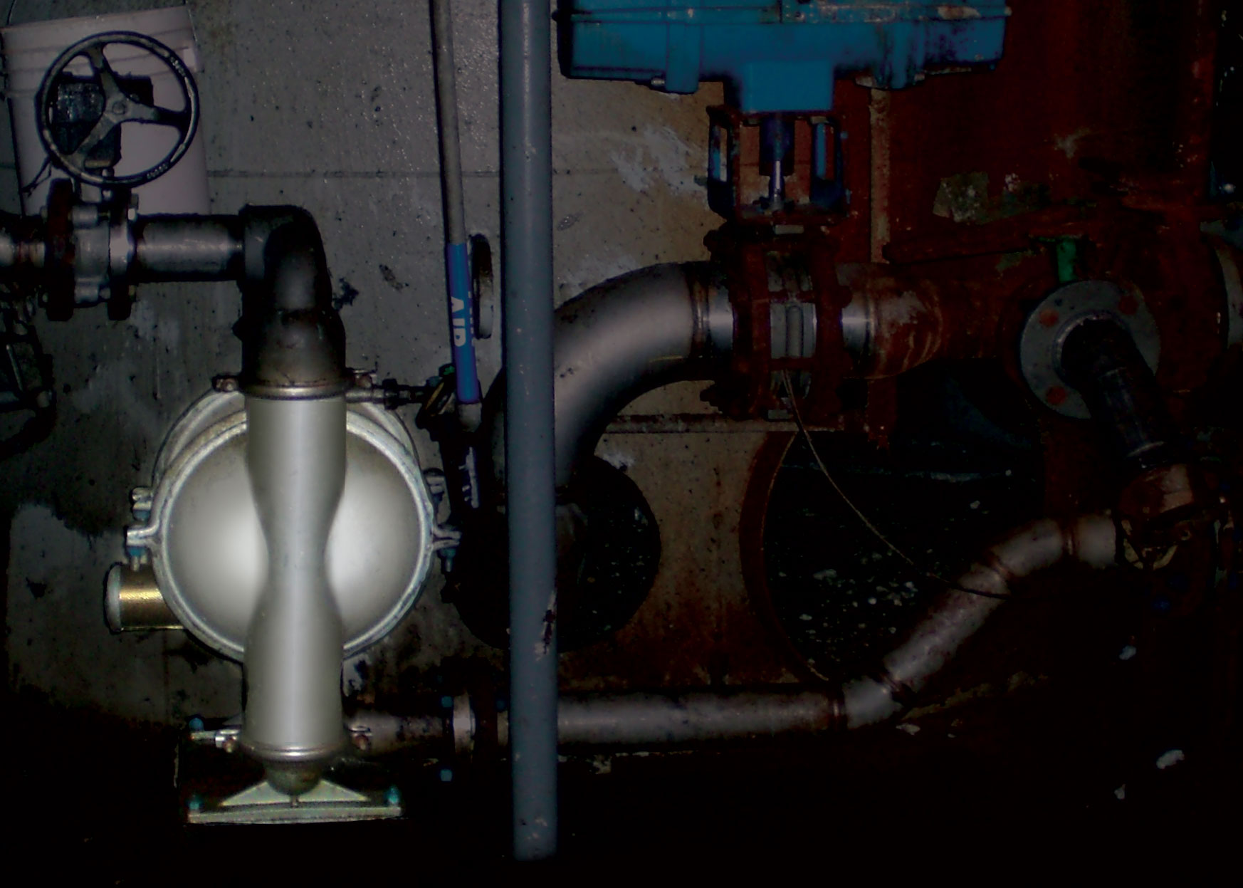

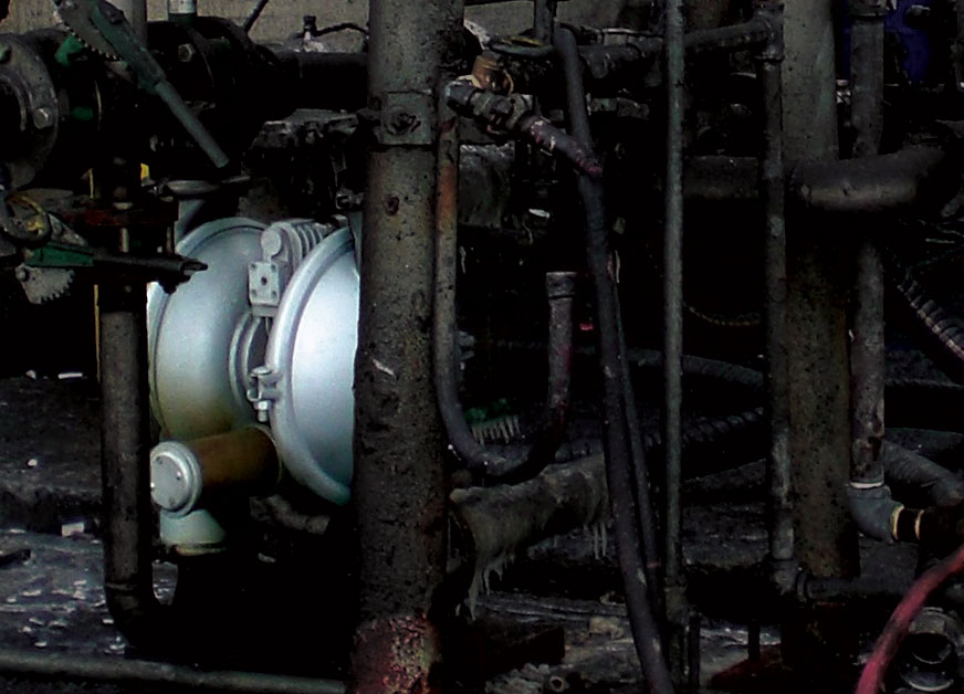

The AODD pump transferring chemicals to the reactor.

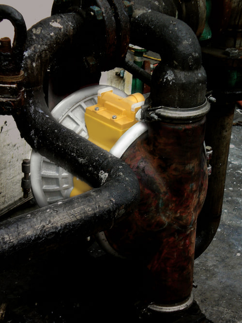

The pump transferring product from chilling tanks to bulk storage.

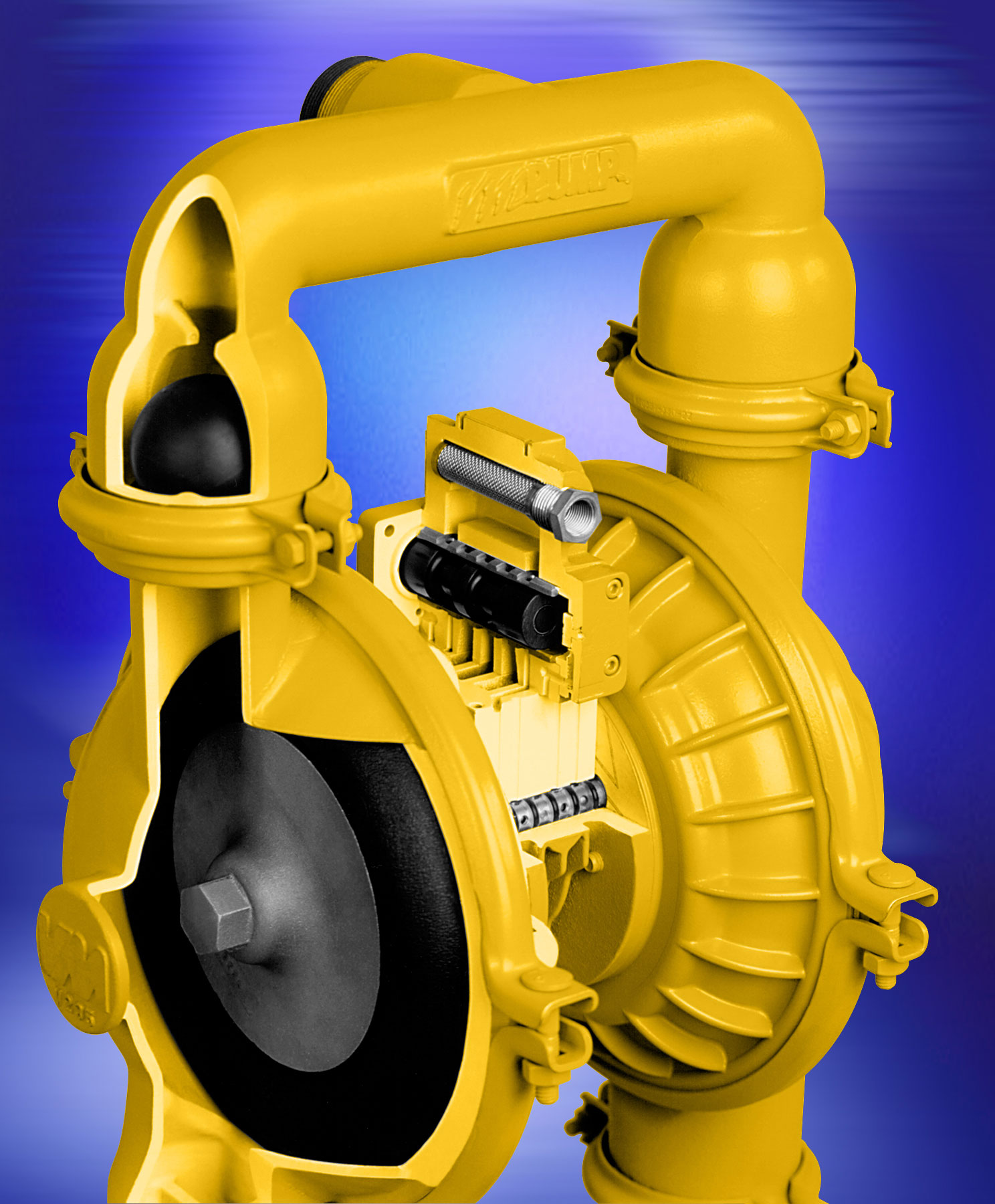

A cutaway image of the inside of the pump that eventually replaced all of the AODD models used in this latex paint manufacturing operation.

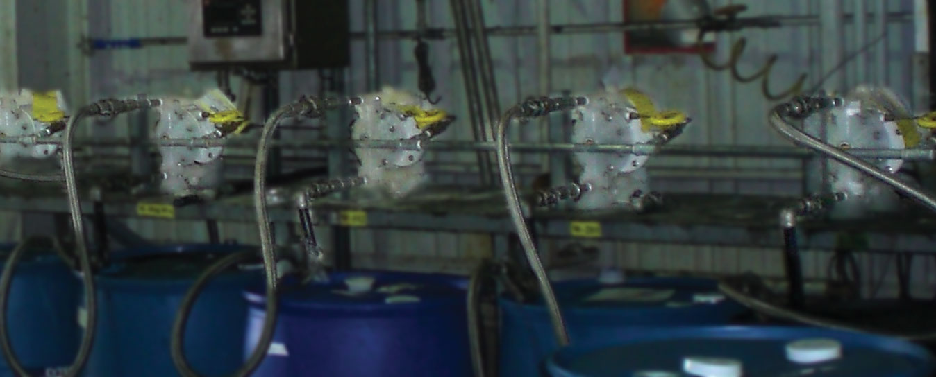

The initial chemical additives are mixed using these pumps.

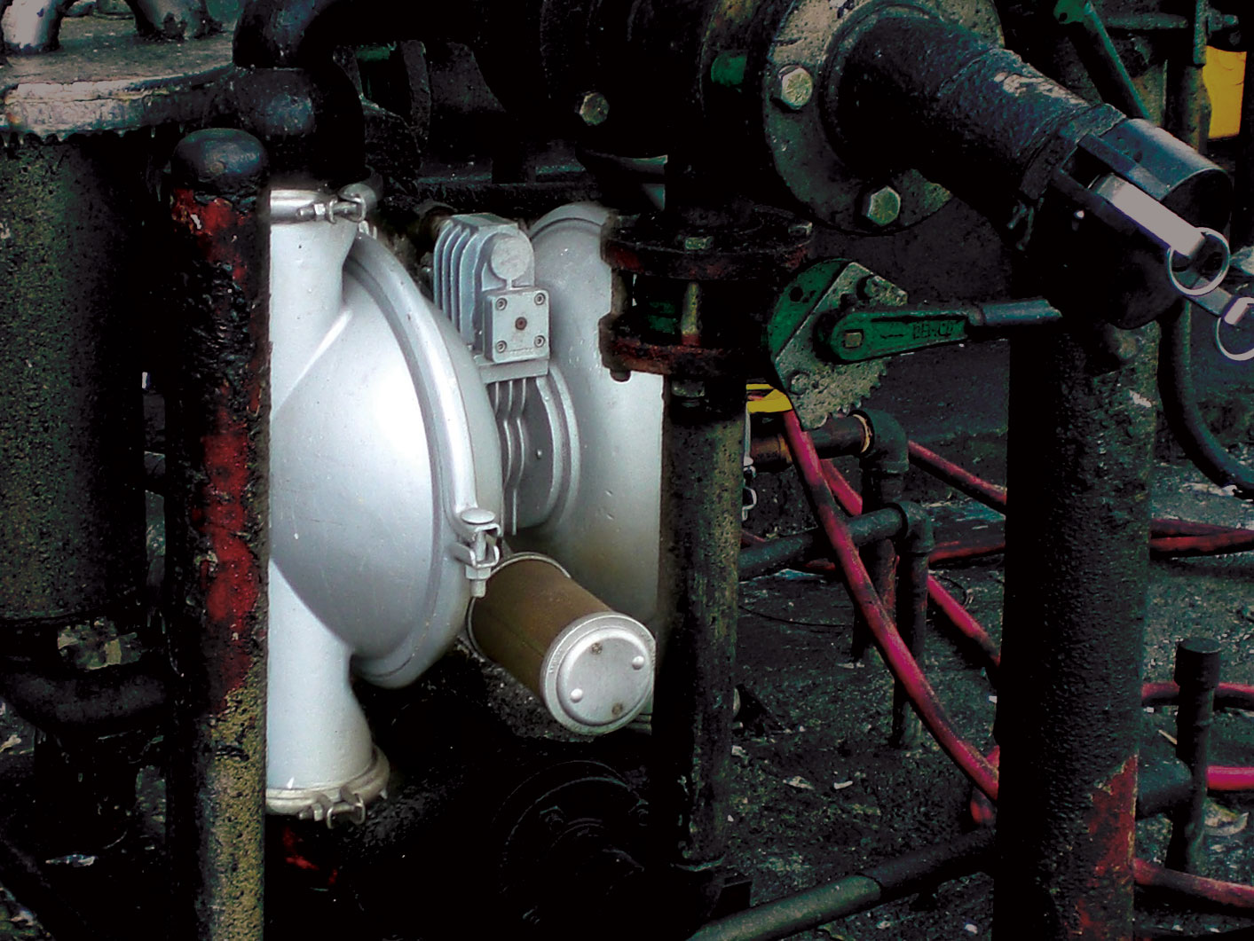

A pump and filter unit used for pumping latex base.

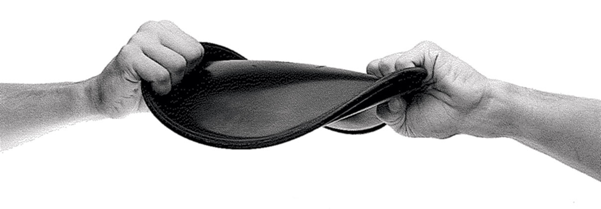

Dome Diaphragm Design
The unique design of this diaphragm is an innovative feature used in the paint industry. Its simple, flexible construction makes it easy to install or replace without pry bars.
The dome shape of the diaphragm spreads wear across the entire part for a longer flexible life.
The dome shape spreads wear across the entire part, allowing it to last up to 300 percent longer than a standard diaphragm that typically focuses stress at one point. The diaphragm’s rolling shape also allows for reliable flow of thick latex and slurry that clog inferior diaphragms. Together, the diaphragm’s easy installation and long flex life minimize downtime.

The air valve system improves productivity because its reliable design yields significant savings in downtime. Primarily, the system eliminates stalling because the air valve spool is positively shifted by the transfer of a pilot shaft. When the main shaft travels to full-stroke length, the inner piston on the opposite side depresses an internal pilot shaft, which ports a burst of compressed air to the main spool valve. The main spool valve reciprocates in a positive, reliable shift. As the pilot shaft moves back and forth, an air burst is ported to the main spool, which causes it to shift every time.
With an anti-stalling design that can handle pressures of up to 200-psi, the system empowers facilities to keep operating so they can produce more.
The AODD pump design also prevents icing. Compressed air evacuates through air passages that are designed to allow a controlled expansion, which considerably reduces the cooling effect. In addition, the center block and air valve surface areas are ribbed and act as heat exchangers to dissipate the rapid cooling effect.
Because the pumps are designed to operate without freezing, companies don’t waste time or resources by having to restart stalled machines or discard ruined batches. Processors even save money when their pumps are not in use – because the specially designed air valve spool prevents blow-by – a costly and messy problem for paint processors.
The simple, user-friendly design of the air valve system also makes maintenance easy and affordable, as the system has fewer parts. Because the pumps are lube-free and self-priming, they practically run themselves — without introducing lubricants that could potentially contaminate the crucial purity of products.
When maintenance repairs are necessary, the design allows for easy access to wear parts. The system has only two center-block O-rings, both made out of a material that is specially blended for long-lasting performance. The pilot shaft O-rings come out as a complete assembly and are easily replaced without the use of an O-ring pick. And the air valve can be reached without taking the pump’s center section apart. These overall savings in time and maintenance costs contribute most significantly to long-term savings and productivity.
