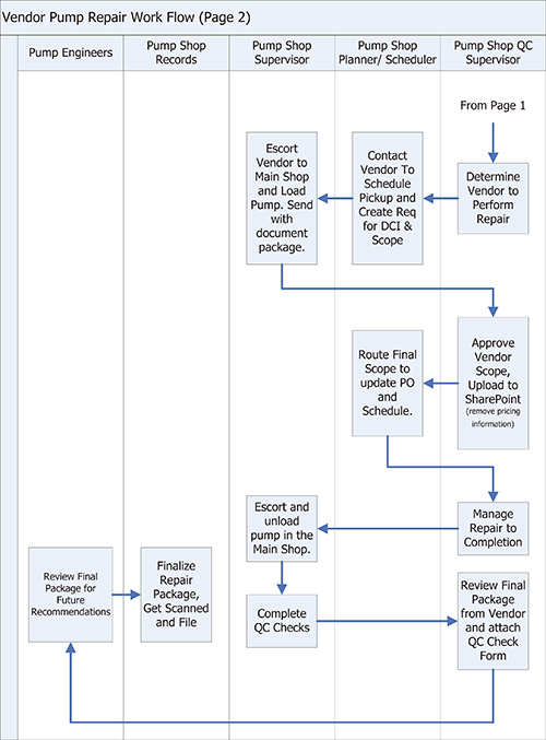

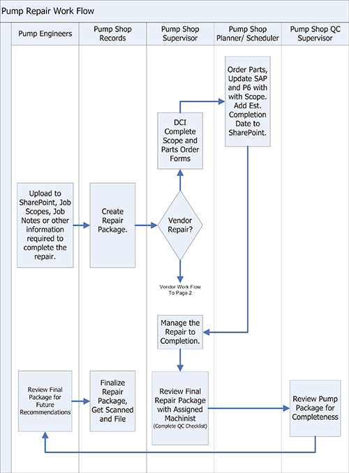

Figure 1. Pump shop work flow
Process Management
After determining the equipment’s current condition, the team began the improvement journey by stating, on paper, the vision of how work should flow through the shops (see Figure 1). Team members established that every pump overhaul within the refinery must be managed by the main shop. If resources were not available, the main shop would be responsible for the repair and manage it through a vendor facility. This provided one point of contact to all support vendors and the team’s internal customers. They only had to contact one person for a decision versus multiple individuals, with varying levels of repair experience, to approve scopes and quotes.
Status
With the owner of the repair identified, the team had to implement a system to notify operating units (customers) of the status of their repairs. By chance, at the same time, the refinery was standardizing its departmental websites. The team decided to use the standardization project to create an internal site for its main shop.
This site is available anytime to internal personnel with intranet access. In the past, a status update email was circulated weekly, but the distribution was limited. With the internal site, anyone may review a repair’s status at any time.
This site also included the functionality to manage repair scopes and information from engineering. Before implementation of the site, engineering would email job scopes for items to be corrected during a repair. This became cumbersome to manage for the shops. With the intranet site, engineering creates a new item to notify the shops of the work and uploads information necessary to complete the repair. The team aligned the site to match its process flow (see Figure 1).
