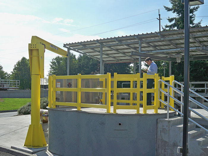

Because of geological restraints, the only available site for the pump station was a narrow space between an existing road and previously installed process equipment. The packaged system provider proposed a version of its system used for submersible pumps, buried below grade. The wetwell with an integral valve vault was made from fiberglass and included an aluminum lid with access hatches. Because the station was only partially buried, the company was able to include safety handrails around the top perimeter for operator safety and a jib crane for equipment removal inside the station.
Testing the Scappoose filter lift station with the mobile HMI.

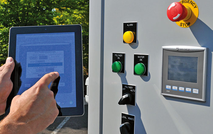

The HMI allows end users to use their iPads to connect to the PLC in their control systems. It works exclusively with certain color touch panel PLCs. It connects to the PLC via a local WiFi router that does not require an internet connection. The onsite mobility allows operators to move freely throughout their plant or station while monitoring or controlling the application. They can watch different parts of a process while maintaining full control of the PLC. Never again will they have to stand outside in the rain to access their system. Sunlight will not affect the visibility of their iPad as it does with outside, panel mounted screens. The best part of this system is that the iPad becomes the HMI and the graphics and controls rendering are the same as on the actual PLC. This allows the operator to switch from the mobile HMI to the PLC’s HMI and back seamlessly.
The document management application works directly with the mobile HMI to create a document management system unique for each piece of equipment to which the PLC is connected. It is a dynamic system because the operator and the pump station manufacturer share important documents regarding the pump station. The documents in the document management system are cached or stored on the iPad for offline use. This ensures that the operator will always have schematics, operation and maintenance checklists, photos, spread sheets, Microsoft Word documents and pdf files that are pertinent to each piece of equipment when and where they need it.
The HMI and document manager can be connected to as many PLCs as the owner has and can be expanded to control each future PLC. This allows for a cost-effective expansion when the operator decides to upgrade or add additional equipment. Additional options are also available that give end users offsite or remote access to each PLC.
Testing the Mobile HMI in the sun
