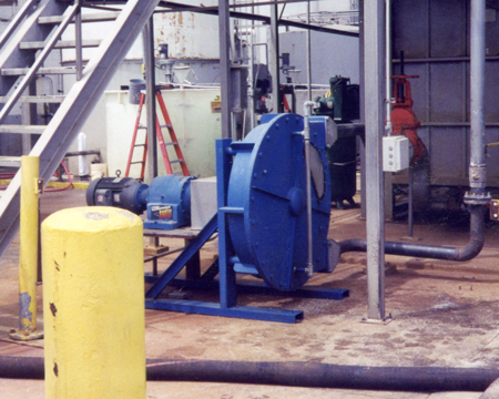

Peristaltic pumps satisfy the requirements of a wide range of applications because their operation is based on the alternating contraction and relaxation of the hose. This forces the contents to move through the pump and into the discharge piping. A smooth-wall, flexible hose is fitted in the pump casing and is squeezed between shoes on the rotor and inside the pump casing. This rotating action moves the product through the hose at a constant rate of displacement.
A typical peristaltic pump
The hose restitution after the squeeze produces an almost full vacuum that draws the product into the hose from the intake piping. The pump casing is lubricated to cool the pump and lengthen the service life of the shoes and hose. Since the product only contacts the hose and not the internal pump components, this pumping technology is a good choice for abrasive and corrosive applications.
This pump style also maintains excellent volumetric consistency, making it ideal for dosing applications. The seal-free design allows for dry-run capability and eliminates any potential leak or contamination points while providing superior suction lift. Finally, peristaltic pumps are easy to operate and maintain. The pump's reversible operation allows for pumping in both directions.

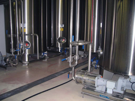

Eccentric-disc technology consists of a stationary cylinder and disc that are mounted to an eccentric shaft. As the eccentric shaft is rotated, the disc forms chambers within the cylinder, which increase at the suction port and decrease at the discharge port.
During operation, the discharge pressure exerts itself against the eccentric disc, preventing it from slipping. This low slip between the disc and cylinder gives eccentric disc pumps the ability to self-prime and line strip. With all these factors, this pumping principle allows for the gentle transfer of fluids from suction to discharge, with low agitation and shear.
An eccentric disc pump
