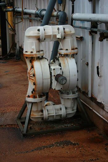

Air-Operated Double-Diaphragm Pumps
Positive-displacement double-diaphragm pump technology was invented in 1955 as the solution for demanding utilitarian applications that need a robust pump design—from chemical and ceramic production to mining and waste-treatment applications. Diaphragm pumps satisfy the demands of these industries because their design allows the product flow to remain constant with the speed of the pump. The pumps can be constructed with a multitude of elastomer options, including Teflon® PTFE, to meet most material-compatibility concerns.
AODD pump
An air-operated double-diaphragm (AODD) pump operates by displacing fluid from one of its two liquid chambers upon each stroke completion. With the AODD pump design, only a few wetted parts are dynamic: the two diaphragms, which are connected by a common shaft; the two inlet valve balls and the two outlet valve balls. The diaphragms act as a separation membrane between the compressed air supply and the liquid. Driving the diaphragms with compressed air instead of the shaft balances the load on the diaphragm, which removes mechanical stress from the operation and extends diaphragm life.
The major benefits of AODD pumps include their ability to be used in a wide range of pressure and flow specifications, self-priming and low-wear operation, ability to handle corrosive and abrasive solutions, consistent performance and lower operational costs.

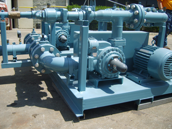

Sliding Vane Pumps
For more than a century, PD sliding vane pump technology has been the number one choice for a wide variety of pumping applications. The list of applications where the use of vane technology sets the standard is virtually endless—the transfer of petroleum fuels and lubes, handling of refrigeration coolants (such as Freon and ammonia), bulk transfer of LPG and NH3, LPG cylinder filling, the transfer of aerosols and propellants and the transfer of solvents and alcohols are among the most popular.
Sliding vane pumps are ideal for these applications because they offer high energy efficiency and low maintenance when compared to other traditionally used pumps, including gear pumps. These are important factors in today's environment of rising costs, lean personnel staffs and high demand for increased profitability. The secret to the success of vane-pump technology to satisfy these crucial considerations are the vanes that slide into and out of slots in the pump's rotor. The pump's rotation draws liquid in behind each vane and as the rotor turns, the liquid is transferred between the vanes to the outlet where it is discharged. This results in continuous, optimal pump performance because each revolution of the pump rotor displaces a constant amount of fluid, while variances in pressure have a negligible effect. This means that energy-wasting turbulence and slippage in the pump are minimized and high volumetric efficiency is maintained.
Sliding vane pumps
Recent advancements in vane pump technology have increased a pump's operational efficiency and longevity even more, including the development of cavitation/noise-suppression liners that control the wear effects of cavitation and reduce noise levels by up to 15 decibels. Motor-speed sliding vane pumps have been engineered for continuous-duty operation. Many sliding vane pumps can be serviced inline without removing the suction and discharge piping.
Sliding vane pump technology has many advantages:
• The ability to handle thin liquids at high pressures
• Dry-run capabilities
• Wear compensation through vane extension
• Good vacuum pressure
