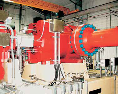

For example, a 12,000 rpm, 12 MW centrifugal compressor at a natural gas pipeline facility in upstate New York was fitted with magnetic bearings instead of traditional, hydrodynamic bearings. This switch to a system that consumes a fraction of the energy (because it rotates without contact) yielded documented annual energy savings of 700,000 kWh and an overall 88 percent energy saving for the compressor system (encompassing compressor and motor). In addition, an auxiliary oil lubrication system, cooling system, gearbox (variable, high-speed motor directly coupled to the compressor), and condition monitoring equipment were eliminated, which reduced the footprint of the machinery and the number of potential failure points.
Centrifugal compressor fitted with magnetic bearings

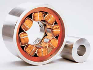

Radial and Thrust Bearings
A typical system incorporates two radial bearings and a thrust (or axial) bearing. Each radial bearing has a stator and sensor system mounted over a ferromagnetic rotor installed on the shaft. The rotor consists of a stack of lamination rings mounted on a sleeve that fits onto the shaft. (Laminations are designed to reduce eddy current losses and improve the response of the bearing.) The stator includes a stack of lamination rings with poles on the internal diameter. Coils are wound around each pole to divide the bearing into four quadrants. The coils in each quadrant are wound in series to make each quadrant function as one electromagnet. Typically on horizontal machines, the quadrants are aligned 45 deg from vertical. Opposing quadrants constitute an axis (each radial bearing, then, can be described by two axes). A set of sensors to measure shaft position is mounted as close to the bearing as possible.
The thrust (or axial) bearing typically consists of two stators, one on either side of a rotor disk as well as a position sensor to indicate the rotors axial position. The stators are made either of solid steel or solid steel wedges with radial slots between the wedges filled with laminations to improve the response of the bearing. The thrust stators also have one or two circumferential slots machined into the face and filled with coils. With a stator mounted on each side of the rotor, the thrust bearing can counteract axial forces in both directions.
Radial Bearing
Radial Bearing

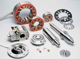

Centrifugal compressor fitted with magnetic bearing components
