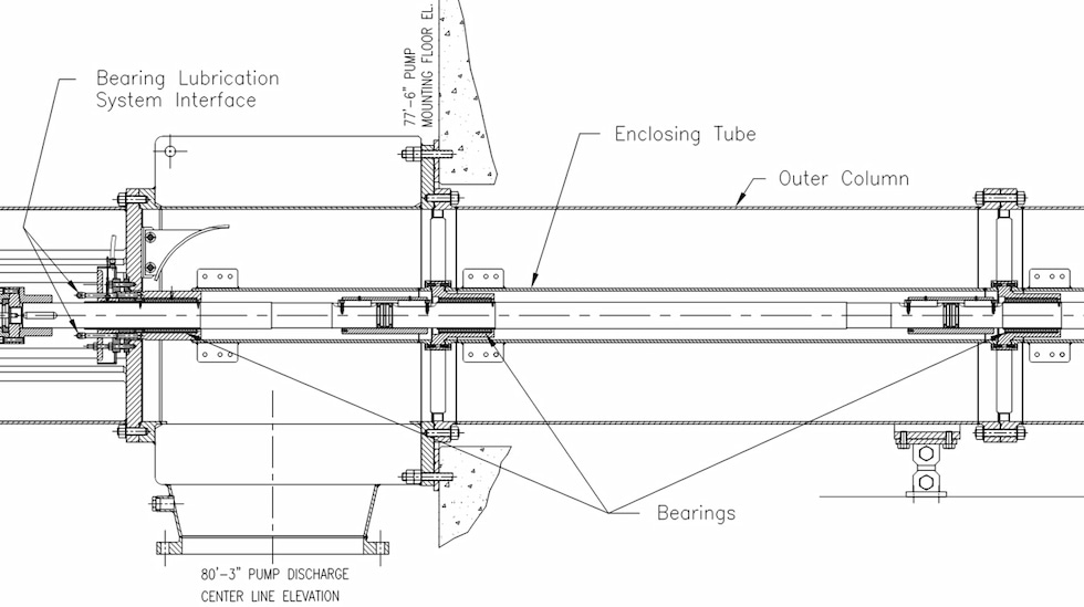

IMAGE 1: Partial cross-section, upper end of pump (Images courtesy of Hayward Tyler, Inc.)

The ESW pumps are single-stage, vertical turbine pumps that provide a continuous supply of seawater—28,000 gallons per minute (gpm)—to the tube side of the component cooling water heat exchanger in a pressurized water reactor (PWR) system. The ESW pumps operate during all plant conditions, including design-basis events, to cool plant equipment necessary for safe shutdown.
Each ESW pump has enclosed line shaft bearings and employs an integral bearing lubrication system for cooling and lubrication of the six bearings along the length of the pump. The system supplies pressurized lubrication flow to the bearings prior to pump startup and continues supply throughout operation. Lubrication flow is injected at the stuffing box beneath the gland packing and doubles as the source of gland leakage flow.
