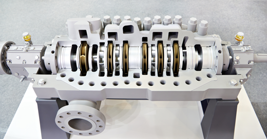

IMAGE 1: Multistage horizontal centrifugal pump (Images courtesy of SoftInWay)
How design differences affect system dynamics and how to account for these effects.
SoftInWay
One of the biggest contributors to pump failure is issues related to rotor-bearing systems. Today, pumps are often designed to operate at increased speeds and loads to improve efficiency. These operating requirements demand that special attention be paid to rotor dynamics analysis during the design stage. This includes simulations of bearings, seals and other components of a pump.
There are numerous pump types available for industrial applications. These pumps can be classified based on design, operating principles, special features, characteristics of the working fluid, configuration (centrifugal, axial, screw, helical, positive displacement) and much more. With each type of pump, there are challenges in terms of modeling and analyzing the rotor-bearing system. On the other side of the coin, many rotor dynamics methods and principles are similar for every rotating machine.
This article will focus on two basic types of pumps: horizontal and vertical, without further specification of the design, to outline common approaches and differences with respect to rotor dynamics, bearings and seals simulations.

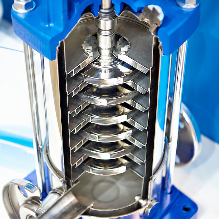

IMAGE 2: Multistage vertical turbine pump
Vertical vs. Horizontal Pumps: Design Differences
The primary difference between vertical and horizontal pumps is the orientation and the shape of the shaft. A horizontal pump has a shaft that is placed horizontally (Top Image), between the bearings or overhung position. The shaft in the vertical pump is positioned vertically. The most common type of vertical pump is the vertical turbine pump (VTP)—Image 2. Vertical pumps (like VTPs) usually have long, spaghetti-like shafts that are connected to the motor (above or below) through the coupling and supported by a thrust bearing at the top or bottom. Another design feature of vertical pumps is the column pipe casing that influences pump dynamic characteristics. These design specifications make a difference in how to approach rotor dynamics modeling and vertical pump analysis.
What Makes Vertical Pump Rotor Dynamics Different?
Flexibility
Vertical pumps have long shafts that cause more flexibility. These flexible shafts have closely spaced modes and a dense range of frequencies. In this case, resonance vibrations with elevated amplitudes may occur, especially if the pumps operate in a wide range of rotating speeds.
The casing structure of vertical pumps (pipe) is also flexible. With that in mind, the pipe casing flexibility, as well as bowl assembly, should be considered when calculating the stiffness characteristics of intermediate radial shaft supports. Additionally, the casing structure of a vertical pump may experience high vibrations due to its flexibility, so frequencies of the pipe should also be analyzed.
Axial forces
Overhung vertical pumps supported by a thrust bearing located at the top of the machine are loaded with axial tensile force resulting from gravity loads. Conversely, if the thrust bearing is placed at the bottom of the machine, a compression force acts along the shaft. Thrust force from the impellers is an even higher contributor to the shaft tension and stiffening. All these forces change rotor bending stiffness, natural frequencies and critical speeds, so it is important to account for these factors through rotor dynamic analysis before a machine ever gets put into operation.

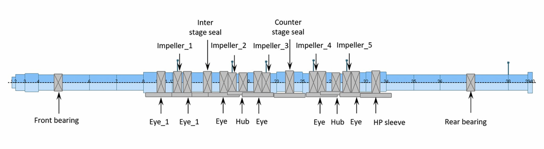

IMAGE 4: A horizontal centrifugal pump (FE rotor dynamics model)
Bearings and seals
The bearing is one of the most critical parts of any pump. Bearings support the shaft and reduce friction on the pump’s moving parts by maintaining smooth rotation of the rotor. Bearings also bring stiffness and damping to the rotor-bearing system. Bearings that are used for pumps can be classified as radial (support the shaft in the lateral direction) and axial (suited for axial loads). The most common types of bearings that are used for pump applications are ball and roller bearings, hydrodynamic oil film (babbitt) journal bearings and pivot shoe bearings (axial thrust load support).
In the context of pumps, seals are no less important. Like bearings, pump seals are the source of stiffness, damping and additional “mass” coefficients to the rotor-bearing system, which change the entire system’s dynamics. A pump’s natural frequencies for systems with bearing and seals differ compared to systems on rigid supports.
Modeling the bearing-seal system differs in vertical pumps compared to horizontal pumps. One difference is a potentially high number of radial bearings that support long shafts in vertical pumps. In many cases, a high number of stages (for example helical/spiral stage types) in a pump increase the number of bearings and seals—the total number of bearings and seals may reach dozens. Image 4 gives an idea of how many elements will need to be modeled to obtain accurate rotor dynamic results. The combination of a long shaft, increased tolerances and misalignments with what is objectively a large number of radial bearings may result in a rapid, nonlinear change in bearing stiffness in bearings where the shaft line gets close to the bearing wall.
The second difference, and potentially even more important than the above, is that radial bearings in vertical pumps are lightly loaded (no gravity force in the radial direction), which makes the estimation of dynamic bearing coefficients more complicated. Unloaded cylindrical bearings are a cause of stability issues in vertical pumps. Thus, nonlinear analysis is essential for an accurate assessment of the rotor behavior of vertical pumps with long shafts and unloaded bearings.
Finally, in submerged pumps, which are mostly VTPs, the bearings are in a pressurized environment and lubricated by the process fluid, often with contaminations. Additionally, the working fluid mixture may change the composition, and the operating conditions of a pump (rotational speed) are often variable. Thus, these radial bearings experience accelerated wear, and the prediction of their characteristics is complicated considering the random characteristics of applied conditions. A worst-case model approach can be used to predict the dynamics and reliability to avoid critical failures.
