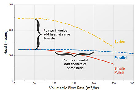

Series vs. Parallel Pumping
Pumps can be oriented in series, parallel or a combination of configurations. Pumps in series add each individual pump’s head rise as the same flow rate passes through each pump. Pumps in parallel operate at the same head rise with potentially variable contribution to flow. Each pump in parallel generally sees the same inlet and outlet conditions, thus requiring the same head rise to be effective. As will become evident through some examples, combining differently sized parallel pumps can cause operating issues due to this head rise requirement. Image 1 demonstrates how operating pumps in each configuration contribute to a composite pump curve. Pump and system curves prove useful when comparing configurations and determining potential operating conditions.
