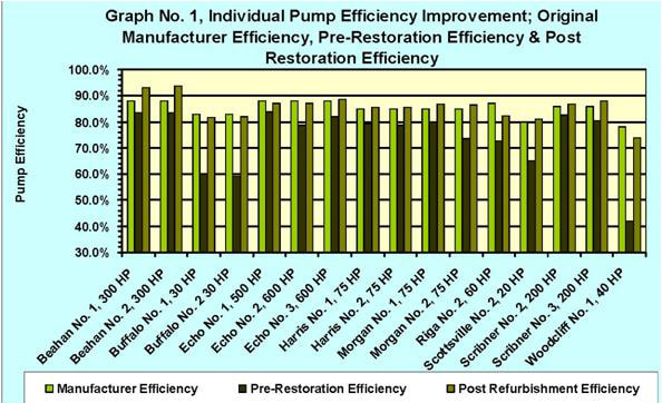

Figure 1 shows the comparisons between the manufacturer's efficiency, pre-restoration efficiency and the post-restoration efficiency of 16 of the pumps in the study. All received mechanical refurbishment and sandblasting/coating. Ten of the 16 had a post-restoration efficiency that exceeded the manufacturer's efficiency, and all show an increase over pre-restoration efficiency. These results suggest that sandblasting and coating could be effective on new pumps as well.
Individual pump efficiency improvemen
Figure 1. Individual pump efficiency improvement: original manufacturer efficiency, pre-restoration efficiency and post-restoration efficiency
Even if they did not improve the efficiency, coating of new pumps delays the onset of efficiency reduction due to corrosion. On average, post-restoration efficiency was 11.6 percent greater than the pre-restoration efficiency.
