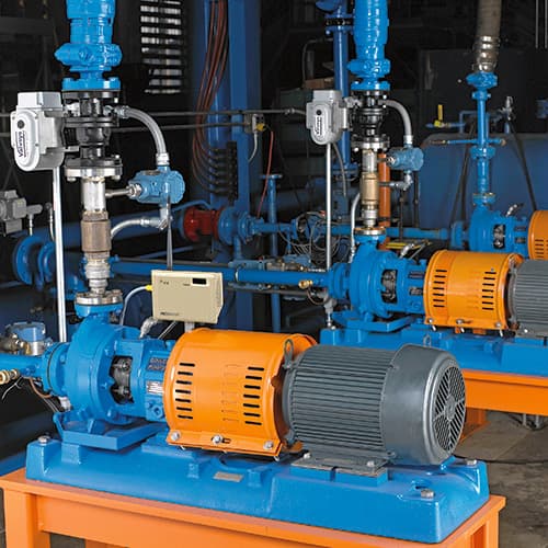

Case Study: A Bleach Plant
Regular pump breakdowns and undue wear resulting from throttling can cost companies millions each year. In one case study dating back to 2001, a paper mill bleach plant suffered from major problems and financial losses as the result of an oversized pump before a plant performance team stepped in to help.
The bleach plant was facing downtime issues that could not be ignored. Internally, an energy team determined that nearly two-thirds of the facility’s valves were less than 50 percent open, and many were less than 30 percent open. One key pump system had a capacity of 6,500 gallons per minute (gpm), but the average load was only 2,750 gpm. The peak flow demand was only 5,200 gpm. The pump was heavily throttled, which resulted in chronic stress on pump components and valves, pipe cracks, gasket leaks and frequent downtime. It experienced failures while running and during startup and shutdowns, which occurred more than 10 times per year.
More damage occurs at startup and shutdown than at any other time, primarily because of the large pressure changes and water hammer across the pump system components. However, the initial shock to the system upon startup involved more than pressure. Thermal shock from 220-degree fluid entering the pipes on startup also occurred.
The mill’s reliability engineers had conducted a thorough examination of the system, determining that the installation of automated gate valves and new operating procedures—to open slowly as pipes warmed to avoid thermal shock and cracking—would provide incremental improvements with a reduction in breakdowns. However, the complete elimination of failures was only accomplished when the plant performance services consultant recommended a low-voltage motor and VFD, operated in pressure control mode, for the three vessels that the pump was feeding. The result was markedly increased efficiency plus a pump system modification that paid for itself quickly.
![](https://www.pumpsandsystems.com/sites/default/files/ITT-Goulds_September-Article-Photo-1.jpg)
Stabilizing the control loops and reducing pressure inside the system took a pump that failed frequently and turned it into a properly functioning component of the system. The bleach plant witnessed $18,000 USD in energy savings in 2002. Energy savings in the same process had climbed to $32,000 per year in 2010 as energy costs increased. Beyond the efficiency improvement, plant representatives reported that the systems-based solution saved them more than $1 million annually in downtime and repair costs.
