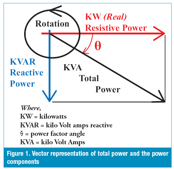

The difference in energy use between the two motors comes from the basic definition of efficiency. Efficiency is real input power divided by (total) output power. Efficiency is a measure to determine the cost of operating the motor. Surprisingly, we do not pay for the total power input, only the “real” component of power.
The total power of the AC induction (reactive) motor can be represented as a rotating vector summation of “real” power and “reactive” power (Figure 1).
Total Efficiency
Another term is needed: total efficiency, which is the total electrical input power divided by the total mechanical output power. For three-phase, AC induction motors:
Total electrical input power for three phase, AC induction motors = line to line voltage • line current • √3

To calculate the total electrical power input, additional nameplate information is needed to calculate KVA:
Motor W = 138 amps full load current: Total Power in = 460 • 138 • √3 / 1,000 ≈ 109.950 kW
Motor U = 147 amps full load current: Total Power in = 460 • 147 • √3 / 1,000 ≈ 117.121 kW
Presuming that both motors are operating at full, rated load, the total efficiency is:
Motor W “total” efficiency = 93.250/109.950 = 84.8%; but nameplated 94.5%
Motor U “total” efficiency = 93.250/117.121 = 79.6%; but nameplated 95.4%
