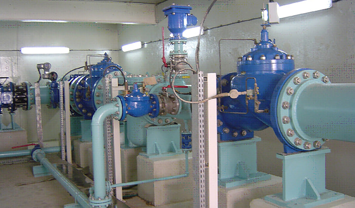

Standard Pressure-Reducing Valve
Standard pressure-reducing valves are available from ½ inch to 36 inches. They manage downstream pressures and are usually offered in ductile iron with a heat-fusion epoxy coating. Stainless steel options are available for 6 inches and smaller. For most irrigation applications, American National Standard Institute (ANSI) flanges will be either Class 150 or Class 300 pound rating. Models 3 inches and smaller are available in thread (Female National Pipe Thread [FNPT]) or flange, while larger sizes are only available flanged. Automatic control valves maintain a constant downstream pressure regardless of fluctuation in upstream pressures. This is different than direct-acting pressure-reducing valves that allow the pressure to change as flows change. Automatic control valves are also known as hydraulic control valves because they require no electricity and the pilots are adjustable, allowing the downstream pressure to be changed. To operate effectively, these types of valves require a differential pressure across the valve of about six meters.![Pressure-reducing valve with solenoid](/sites/default/files/0717/Singer-Image-2-TONED.jpg)

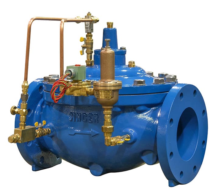

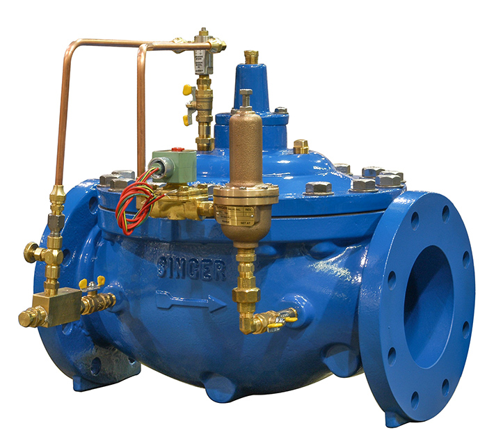

Standard Pressure-Reducing Valve with Solenoid
A solenoid can be added to a standard pressure-reducing valve so the equipment will respond to a timer. For example, this might be used as a master control valve for a system coming off a shared supply. The master valve is only on when irrigation is required. When irrigation is not required, the system is not pressurized.Pressure-Relief Valves
