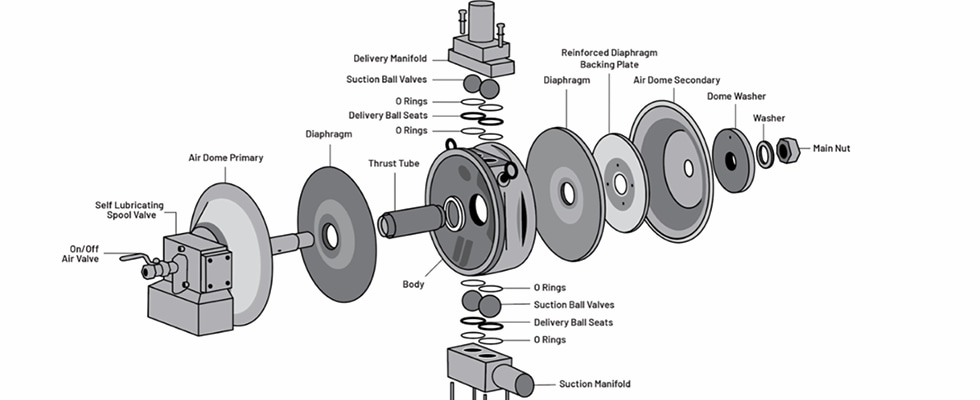

One drawback to this design is pulsation in the discharge line. AODD pumps may not be suitable for precise filling applications that require steady inlet pressure. Another drawback is the time it takes to disassemble a traditional AODD pump for cleaning or maintenance. The two sets of pipework have many sections and bolts that must be removed before workers can gain access to the diaphragms.
IMAGE 2: An example of a fast-to-disassemble AODD pump
A newer, alternate design of the AODD pump routes the process fluid through the center of the pump and routes air on the outside of the pump (Image 2). A worker can access the pump internals by removing a single large nut. This one-nut arrangement eliminates the need for extra pipework and allows for a central fastening point in the pump assembly.
A team member can disassemble, clean and return to service this kind of pump in 15 minutes compared to the two hours it takes to do the same process with a traditional AODD pump. A traditional AODD pump cannot be cleaned in place because the maximum inlet pressure is limited to as low as 10 pounds per square inch (psi) in some cases, which is too low for the pressure required to adequately clean the pump in place.
In contrast, the alternate one-nut design permits the installation of optional diaphragm support plates that allow operators to safely feed up to 100 psi at the inlet. The pump becomes part of the line being cleaned by the CIP system.

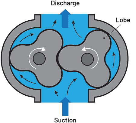

Lobe pumps are rotary pumps. The rotors may have lobes that are rounded or have sharp edges. As seen in Image 3, the process fluid enters the center. As the twin rotors turn, they pull the product around the pump housing and then push it out through the discharge port on the other side. This is a gentle handling technology. Lobe pumps have large cavities that pump large solids and particulates without damaging the integrity of the product.
IMAGE 3: Diagram of a lobe pump
Typically, lobe pumps are cleaned in place. In some applications, such as the transfer of ground meat, CIP is insufficient to remove all of the product, and the pumps are cleaned manually. For such applications, it is important to get a lobe pump that is designed for COP. Such pump designs have fewer parts and may not even require tools for disassembly. Some COP lobe pumps can be cleaned in minutes rather than in hours.
Hygienic lobe pumps are available in a wide variety of sizes, from 1/2-inch to 8-inch connection sizes. Consequently, they offer a wide range of flow rates. In food processing, sometimes very low flow rates are required, and lobe pumps in smaller sizes can be the ideal fit. Lobe pumps are compatible with a wide variety of products, including high-viscosity and shear-sensitive products, even at high flow rates.
