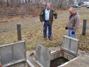

(1.-r.) John Bresler (Jett Pump and Equipment) and Bud Avery (City of Inkster) looking at the John Daily CSO lift station with the SHSeries installed.
