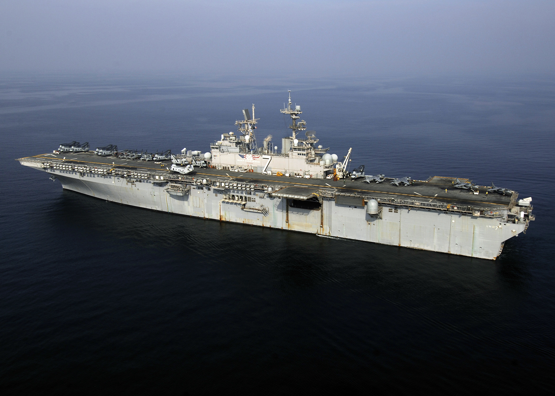

In October 1990, the USS Iwo Jima was heading into port for routine maintenance in Manama, Bahrain. The ship was the first to be designed and built from the keel up as an amphibious assault ship in Puget Sound Naval Shipyard, Bremerton, Washington, on Sept. 17, 1960.
Valve 2MS-7 was a globe valve in the boiler room, and it needed to be repacked for a small packing leak and reconditioned while in port. The valve was worked on by an outside contractor who had limited understanding of military specifications and procedures.
