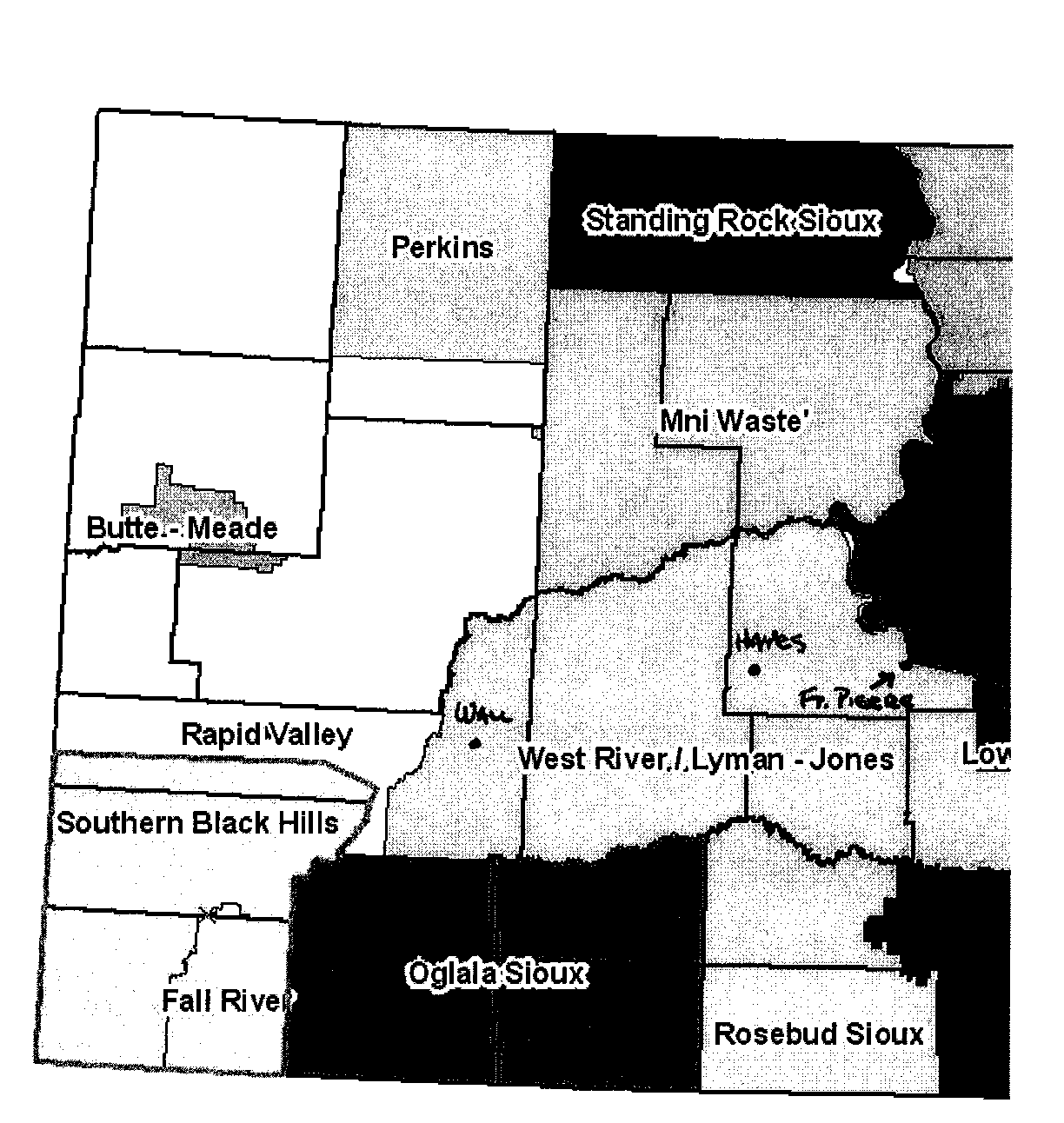

WR/LJ rural water, based in the small South Dakota community of Murdo, is physically one of the largest rural water systems in South Dakota. The North Core Pipeline Project, Phase 1 (NCP1) started in November of 2004 with the assistance of the Department of Environmental and Natural Resources and the Bureau of Reclamation to secure funding for the project.

The entire WR/LJ rural water system currently serves approximately 2500 connections, both domestic and livestock, with another 200+ in areas yet to be served. The NCP1 is the first segment consisting of approximately 38 miles of 16-in and 14-in diameter PVC pipeline that will deliver Missouri river water from the Mni Wiconi Water Treatment Plant near Ft. Pierre, SD, to the northern and western portions of the WR/LJ water system, with water reaching nearly 150 miles west to the world famous tourist attraction of Wall Drug, located in Wall, SD.
The NCP1 will immediately impact 400 connections northwest of Ft. Pierre. The project is especially important for the connections north of Hayes, where water service was intermittent during the summer months due to limitations of a temporary supply line, and connections south of Hayes that was constructed this summer and will be served through taps to the core line.
