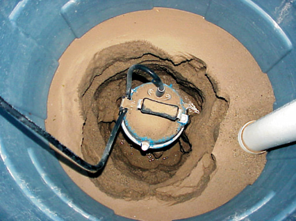

Also, look for features such as a dual, an inside mechanical seal with silicon carbide seal faces. A quality mechanical seal translates to longer pump life. As these portable pumps do not depend on close impeller tolerances to maintain performance, manufacturers offer unique impeller material and designs—such as urethane rubber coated semi-vortex impellers.
A urethane rubber coated impeller will be more resistant to wear from abrasive particles, such as sand, than a cast iron impeller. Some pump manufacturers incorporate an agitator attached to the shaft through the impeller which mixes and suspends sand and debris. This design is favorable to a non-clog type trash pump for a construction or dirty water application.
